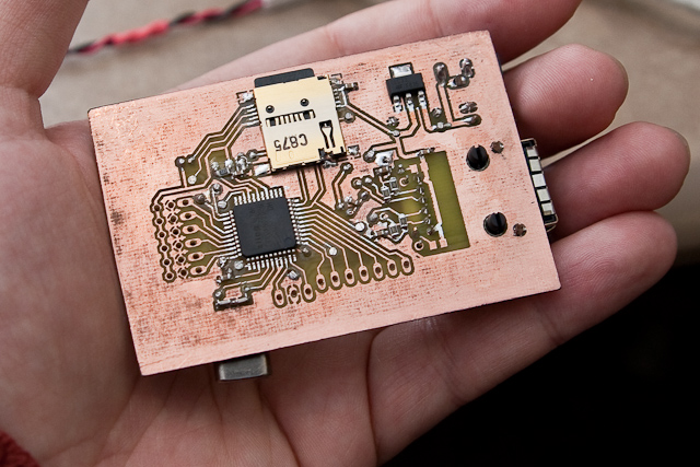

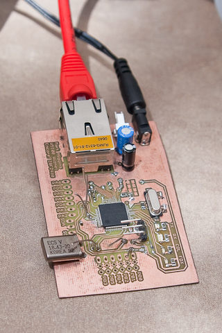

How-To: Web server on a business card (Part 2) - Hack a Day
Who would have guessed…?! I know this web site, but this article is new to me… and thinking that this was new, hmm, now here’s a new dilemma, PIC24, I don’t have one small like this one… I only have the 64 pins ones, should I get some small PIC24 like the ones they use or should I change a little and build a PIC32 based ?

I don't use PIC's. But to give you an idea on what to look for, speed is not really an issue here, the only thing I would look out for is FLASH memory. I've done this already, but I used a Z8 Encore! chip. All I can say is that 24k was definitely not enough to put all the functionality I wanted on it and I didn't need to put a TCP/IP stack on it like you do, so I later made one with a AT91SAM7. I would have liked to have been able to log data to SD card as well as just read pages and report over HTTP, but putting both the FAT16 read and write with all of the other code was too much for the 24k of flash. All I did was use special codes within the HTML pages that the uC would scan for when serving them up. If it found the code, it would insert whatever data the code was for, so there were codes for pin statuses, ADC values, sensor readings...
...and it's not that expensive to do ARM development. $50 for a USB JTAG programmer. The free GNU based development solutions are pretty annoying, though. I just went with a personal license for Crossworks, which has worked out great. Also it means I have a single programmer/debugger and development environment for a large range of chip classes; OS class ARM9, specialized ARM7, super cheap Coretex-M3, and low power Coretex-M0 so far. They've pretty much replaced everything else I worked with.
