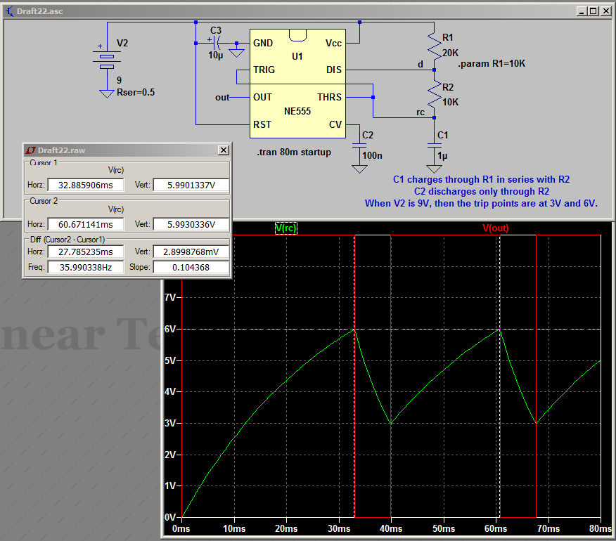

Look at the attached simulation. Notice that when running as an astable (oscillating), the timing capacitor charges through R1 and R2 together, but discharges only through R2 (when the "discharge" pin is turned on). See the green trace V(rc). Note how it varies between 1/3 of 9V and 2/3 of 9V. Ignore the first charge cycle because it is starting from zero, not 3V like all the subsequent ones.
This makes the period proportional to (R1+R2)*C1 + R2*C1 = C1(R1 + 2*R2) = 1e-6(20K +2*10K) = 4e4*1e-6 = 4e-2 = 40ms. The actual period measured from the simulation is 27.7ms (cursors), so the proportionality constant to calculate the period would have to be ~0.7, or Per=0.7*C1(R1+2R2).
This makes the Frequency = 1/Per = ~1.4/(C1(R1+2*R2)). I will let you calculate the time it takes to charge, and the time it takes to discharge the capacitor. This determines the duty cycle. Note that V(out) red trace is high longer than it is low.
It is tough to make an oscillator with a duty cycle shorter than 50% with this 555 circuit.

Thanks for your help. I kind of understand what you are saying. I think I need just to try it out a little more. but as you said in the real world it does differ.. Because i went on playing turning the Dc supply till even under 3V and it kept working flashing, and then i raised it up to even 15v and the timing did differ a bit.
Thanks for you reaction. As you said for the a stable it the wrong formule, I just mixed it up because i kept trying all circuits over and over because it didn't work as i Said the LED kept on... you might also have a opinion of why that supply doesn't work to gether with the 555?
The reason for the Capacator to only discharge from R2 is because the transistor goes on after the 2/3V is reached right ?
As for your question it is a little bit confusing bit i think i get it.. i am new to reading formules on the internet when i write it down it comes easier... But the point which iI don't get is what did you measure from the simulation the 27.7ms? is that like a constant? because in the notes that i took while searching is the fellowing:
T1 (charing) = 0,693(R1+R2) x C1
T2 (discharging) = 0,693 x R2 x C1
T= T1 + T2 = 0,693 (R1 + 2 x R2 ) x C1
f = 1/T = 1.44 / ( R1 + 2 x R2 ) x C1
And the point is in the beginning of your formule you don't have the 0,693 and you add later the 27.7ms and after that it becomes the same formule.. so i that 27.7ms always the same?
as for this formule the charging time will be = 0,693 ( 20000 + 10000 ) x 0,00001 = 0.02ms
and the discharing should be = 0,693 x 10000 x 0,000001 = 0,06 ms ..
1,4/(1e-6(20K + 2 x 10K)) = 35 so what did this 35 means exactly? it's frequeancy but what makes it do exactly?
