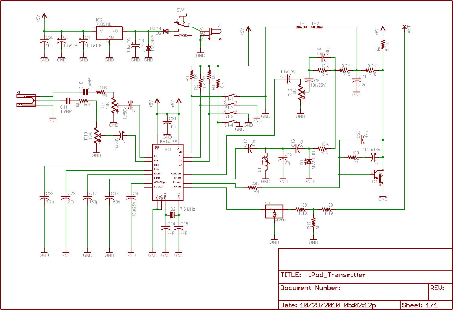

Hello everyone. A friend of mine asked me to build him a small FM transmitter so he could broadcast an mp3 player to his car stereo. I found plans online and built the circuit on this page:
I believe I didn't make any errors in laying out the schematic or board and I'm pretty sure there are no problems with the board itself (i.e. broken traces, shorts, etc.) The only problem is, it doesn't work.

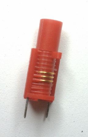

When I try to perform the steps at the bottom of the page labeled "Test & adjustment" I'm running into problems. The voltage at TP2 is 5V and adjusting the slug of L1 makes absolutely NO difference. The type of adjustable coil I'm using is this:

I've done some poking around trying to troubleshoot the problem and I've discovered that the voltage at the end of L1 that's not connected to ground is 0V. Also, the voltage at pin 9 is about 2.9V.
Lastly, and I'm not sure if this is normal but the BH1417F IC gets hot when the circuit it powered. It's not so hot that it burns my finger but it's noticalby warm.
Anyway, if anyone has any ideas about what might be wrong or how I can further troubleshoot please, please, please, let me know. If you need more information to help me just let me know and I'll provide whatever I can.
I also posted a screen shot of my .sch file. I didn't want to post the file itself because it uses a lot of modified libraries but if anyone wants it I'll zip the .sch, .brd, and all the necessary .lbr files.
As always, thanks in advance for any help you can offer me.

Your coil L1 is most likely your problem. You need to build it exactly as in the article. You should use same ferrite core as recommended in article. Your coil seems to be higher up on the coil former than in the article, this will add inductance and change your osc frequency.

I looked around online a lot for a coil like the one in the article but couldn't find anything. Got any suggestions or know of any sites where I could purchase a suitable coil or parts to make one? Also, if anyone here has what I need, I could buy it directly from them. Lastly, in your opinion would the difference in L1 between what I used and what's in the article be responsible for the voltage at TP2 not changing at all. Even if the inductance was different than what the circuit was designed for, I would expect the voltage at TP2 to change at least a little. What do you think?

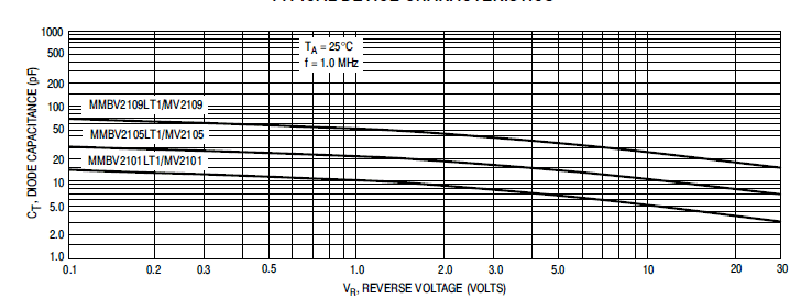

The reason the voltage at TP1 is at 5V is because the frequency is too far off. The TP1 is going to 5v rail in attempt to lower the varactor capacitance, but can't go beyond 5v. This is indicative of your using a different varactor.

Well... You are right, the parts list does say the 2109 is an alternate, but if you compare the graphs from the data sheets below you will see they have very different specs, so now I am confused :(
From what I can see, the 2109 is around 40pf @ 5v, the 833 is 20pf @ 5v.
I'm seeing about 22pf for the 833 and 35pf for the 2109. How can we tell if that difference is significant?

Lets analyze this. Since TP1 is at 5v we can assume the osc freq is too low because if it was too high TP1 would be at 0v. This is true because if you look at varactor graph capacitance decreases as voltage increases. So if it is to low, we need less cap or less inductor. Thus we need less length in L1. So try playing with that. Does that make sense?

OK, I'm making progress at least. I switched out the adjustable coil for an air coil and slowly adjusted the length of the leads that were soldered into the PCB until TP2 was around 2V. So it appears L1 was at least part of the problem. Now, it is transmitting on the expected frequency but I don't hear music. Instead, there is this annoying repeatative warbling tone. It is obvious that it's coming from my transmitter because when I switch it off, the radio goes to static.

i suppose that your regulator is wired correctly as the sch screen dump showed reverse connection of input and output. the best appears to use air cored coil. you can make a turn extra, tune Rx to mid frequency like 98 or 100MHz. feed the input.

Good catch on the regulator. I did make the mistake of connecting it backwards in the schematic. Fortunately, I realized this before I soldered it in the board and just flipped it around. So, the 7805 is soldered in correctly and at least that part of the circuit is working.
