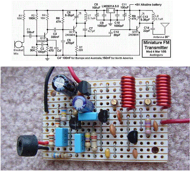

I am open to suggestions as to which design to use. I have thought of using part of Audioguru's fm transmitter (mod4) for this job, or this Ipod 1w xmitter which seems a bit overkill.
Question 4:
If i use Audioguru's circuit i would need to couple BH1415F pin 11 (apparently expecting 50ohms impedance) to Q3. Here i am totally at a loss on how to calculate and implement the impedance matching. I'm looking for pointers or a cookbook approach / reference on soving this.. i'm getting back into electronics after 25 years and those particular memories have been recycled long ago :)

Range depends on the issue of plain rural ,open area or congested concrete forest of City area.
As AudioGURU himself told, it covered an range of almost 2KM across an open area,with a good Receiver, even with a nominal antenna. Wattage emitted , depends more on impedance matching of the antenna.
The FM stereo transmitters made for cars have an attenuator at their RF output. The Micromitter project and kit has an attenuator that reduces the output to 10uW so that there is less interference to nearby radios and so the output power is legal.
You can remove the attenuator (it is on the circuit board) then the range will be maybe 500m.
My FM transmitter is not stereo so its range is much more.
FM stereo (it is old) is not DVD (it is new) quality.
The frequency response is 50Hz to 15kHz, not 20Hz to 20kHz.
The signal to noise ratio is 60dB, not 110dB.

I had not realized Mod4 was mono, had not thought about the frequency response (FM quality will do) and never thought the micrometter would get 500m without the attenuator.
I now have my plan: properly understand antenna matching, then modify the attenuator in my centronic fm transmitter to get 100m. The output is about the same for both chip.
