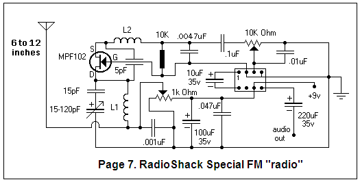

The article has links to a parts list, pcb design and schematic. Here is the extremely simple schematic:
Audioguru, really, how could you!!!!
Proposing a super-regen to receive wideband FM!!
After all you said to poor misguided mstecha:D :D :D
Somebody else recommended that crappy circuit that I don't even call a "radio". Maybe it will work in Sri Lanka where it might pickup the only FM station in the country, if it isn't too strong or isn't too weak.
He wants it to receive the crappy simple FM transmitters. Which will drift its RF frequency more??

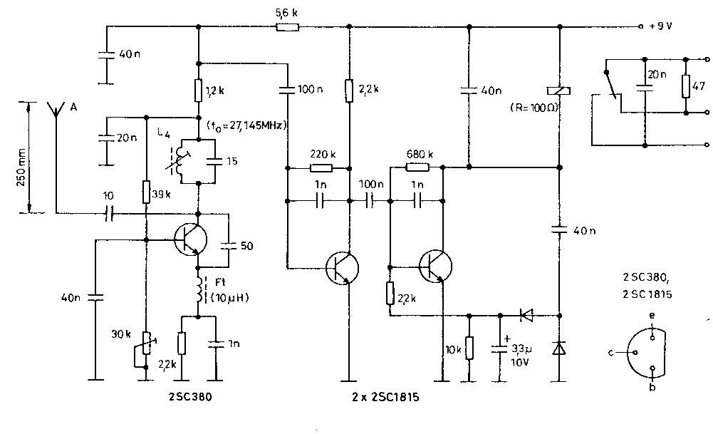

can any body give me an FM receiver used in RC cars.....
Here is a 1-transistor super-regen "radio receiver" from a toy car:
