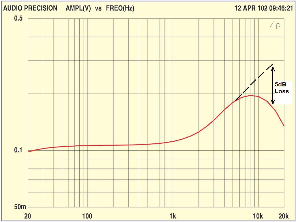

My FM transmitter isn't crystal controlled so its tuned frequency drifts a little. The crystal controlled tuning in the Stereo Micromitter probably has better frequency stability than Adam's truck radio.
For those of us who can still hear well, the audio pre-emphasis response on my Mod4 FM transmitter is flat to 15kHz after de-emphasis by a radio, while the Stereo Micromitter's response begins dropping above 6kHz and is down 5 dB at 13kHz and much more loss at 15kHz. :lol:
