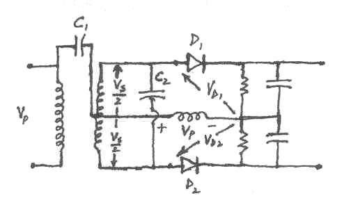

This wikipedia explanation tells nothing. Anyone have a detailed explanation of the circuit. I didn't understand the underlined portion.
It uses a tuned RF transformer to convert frequency changes into amplitude changes. A transformer, tuned to the carrier frequency, is connected to two rectifier diodes. The circuit resembles a full-wave bridge rectifier. If the input equals the carrier frequency, the two halves of the tuned transformer circuit produce the same rectified voltage and the output is zero. As the frequency of the carrier changes, the balance between the two halves of the transformer secondary changes, and the result is a voltage proportional to the frequency deviation of the carrier.

I didn't understand a single word u told. Please give me a detailed explanation.
When the input equals the carrier frequency and how the output become zero.

Hi Eric,
I'm going to design a discrete fm detector circuit.
With minimum circuitry but acceptable performance.
For that I want to get a clear picture of the working principle of the available detectors.
It's on fm broadcast communication range only for audio.

Guruji,
Please explain a highly detailed view of this thing:
What is happening on each section and what is the input of the transformer etc :)
