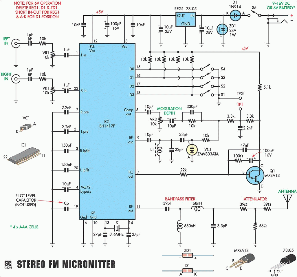

Rohm make some FM transmitter ICs. Their latest one uses a crystal oscillator with PLL. It is fairly small with 22 pins and is surface mount. Many of the MP3 to car radio transmitters on the market use it.
It is in a project by Silicon Chip magazine. Go to Google and enter Stereo Micromitter in the search box.
The project includes all the stuff for it to transmit in stereo, and with pre-emphasis (treble boost) that perhaps you don't need. It also includes an RF attenuator to reduce its range that you will probably leave out.
RF frequency selection in the 88MHz to 108MHz FM broadcast band is with up to 8 DIP-switches, 4 frequencies near the bottom of the band and 4 more near the top.
I saw a small MP3 to car radio transmitter made by Maxell (cassette tapes and CDRs) with only 4 frequency selections, its size was just big enough for it to hold 2 AAA cells and it was selling for about 20 bucks. :lol:
As I said, the main problem is the transmitter. Any device built so far is instabile, and cannot be used as a "body transnitter". Even if you go near them they deviate :(

What's wrong with the circuit Audioguru posted above?, it uses a crystal controlled PLL and should be nice and stable!.
Also, it's advisable to build it (or any other transmitter) in a fully screened metal box, and mount the aerial on an external socket.

I have an almost similar circuit, using MC145168 IC.
About the same Xtal.... it's too big, I need a much smaller one... I know it's possible as I've seen it working in UK several years ago, but haven't bought it (stupidity)... Several...I think 5 transistors, no IC, worked like a charm... Body transmitter, about 1.5 x 4 cm....
How can they do it is not clear... I don't remember the name of the firm, but it has ready made devices only, but I got a privilege as they show me their lab...
Thanx a lot... :)
@Nigel Goodwin
well, nothing wrong with the circuit.... but is BIG ... :lol:
I've done a search at the forum, have seen it before... but here the size counts !!! :lol:

It's pretty small for what it does!, and the chip is only 22 pin and surface mount, I think your requirements are probably unachievable if you're wanting to get it any smaller?.
Circuit looks OK and can be modified for frequency you want. Problem can be to find appropriate crystal. Output power is only 10mW and at 120MHz will be lower. I think it is not enough for 300m distance.
