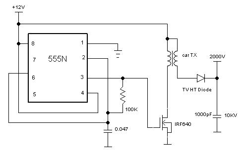

My father needs a fly killer for his meat store in the market. It must be for 12V. I took one of 220V and changed the 4oooV transformer with my circuit. I also changed the UV lamp to UV LED. The transformer is from the spark in our old car and the diode is from old TV. I can get only 2000V but I need 4000V. Can you help?
My guess is the pulse rate is too high to allow the inductor current to ramp up to a sufficient value. You could try increasing the resistor value (e.g. double it) to reduce the pulse rate and hence prolong the ramp. However, increased inductor current would also mean a higher back-emf spike when the FET switches off. Your FET is rated for only 200V. Ignition coil spikes are typically higher than that, from what I read.
Do you know the coil's primary inductance? Do you know the diode's voltage rating?
I agree that the fairly low voltage rating of the Mosfet is clamping the voltage spike.
Thank you guys for supporting and the liking my "practical solution".
Another solution: from experience I know that the ignition transformer have a turns ratio of about 1:30 , it means that the high voltage can come from back emf only. I also know from experience that the mosfet will explode the first time the voltage will go over 200V.
My suggestion is to revers the diode. The reason is that we can't tell the direction of the winding and it could be that the negative spike caused by back emf is higher in amplitude.
If that doesn't work then it likely to be what alec_t said.
Use a TIP152 transistor to drive the IGN coil, they are an ign switching transistor ive been using. You should get around 20KV from an ign coil. TIP152 transistors are quite cheap from China on Ebay. I purchased 10 from China on Ebay & they work fine in IGN circuits, they were marked as made in the Philipines.
Why does the fly killer use a diode to make DC? A car ignition circuit does not use a diode so the polarity of the high voltage does not matter.

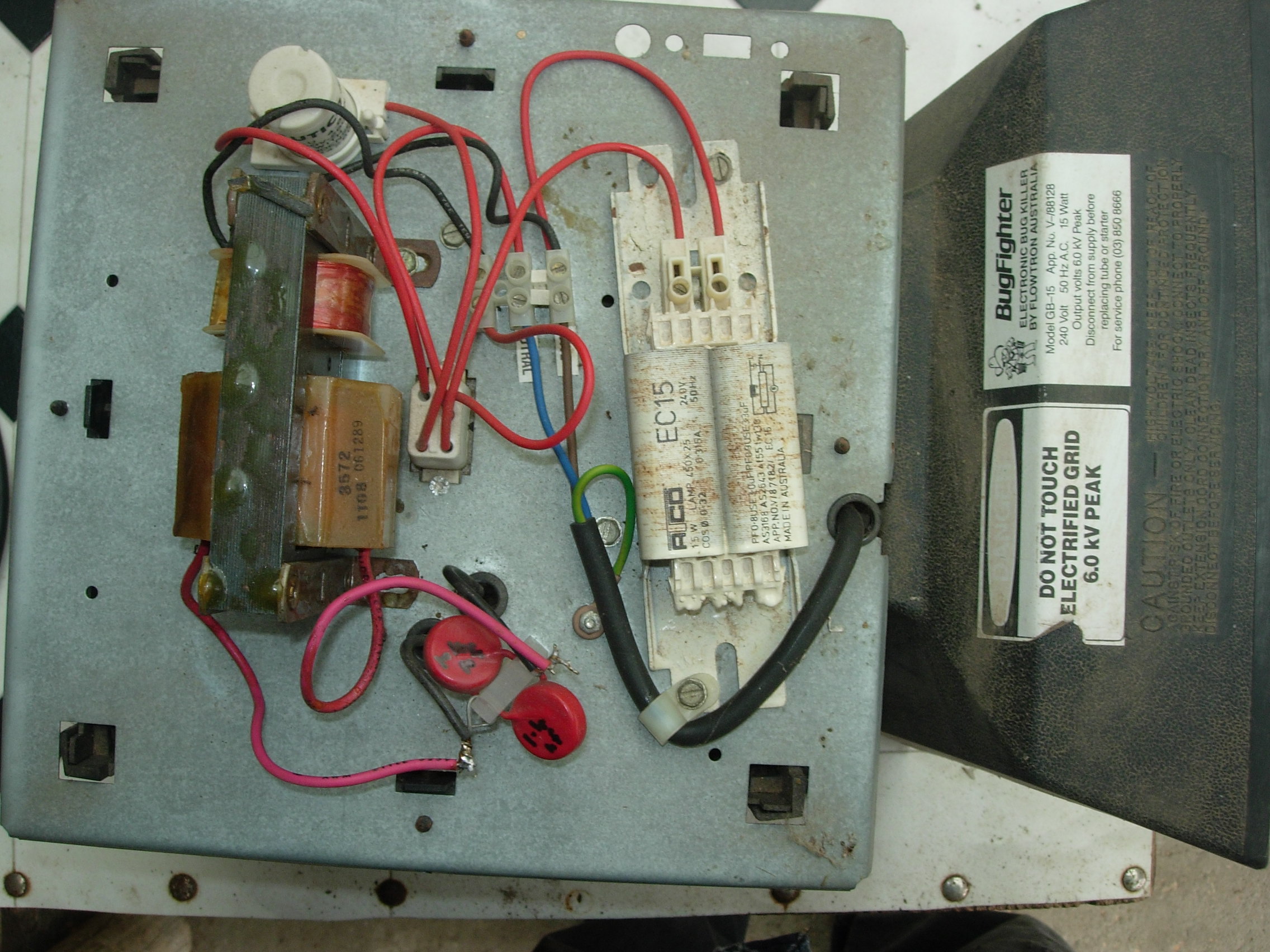

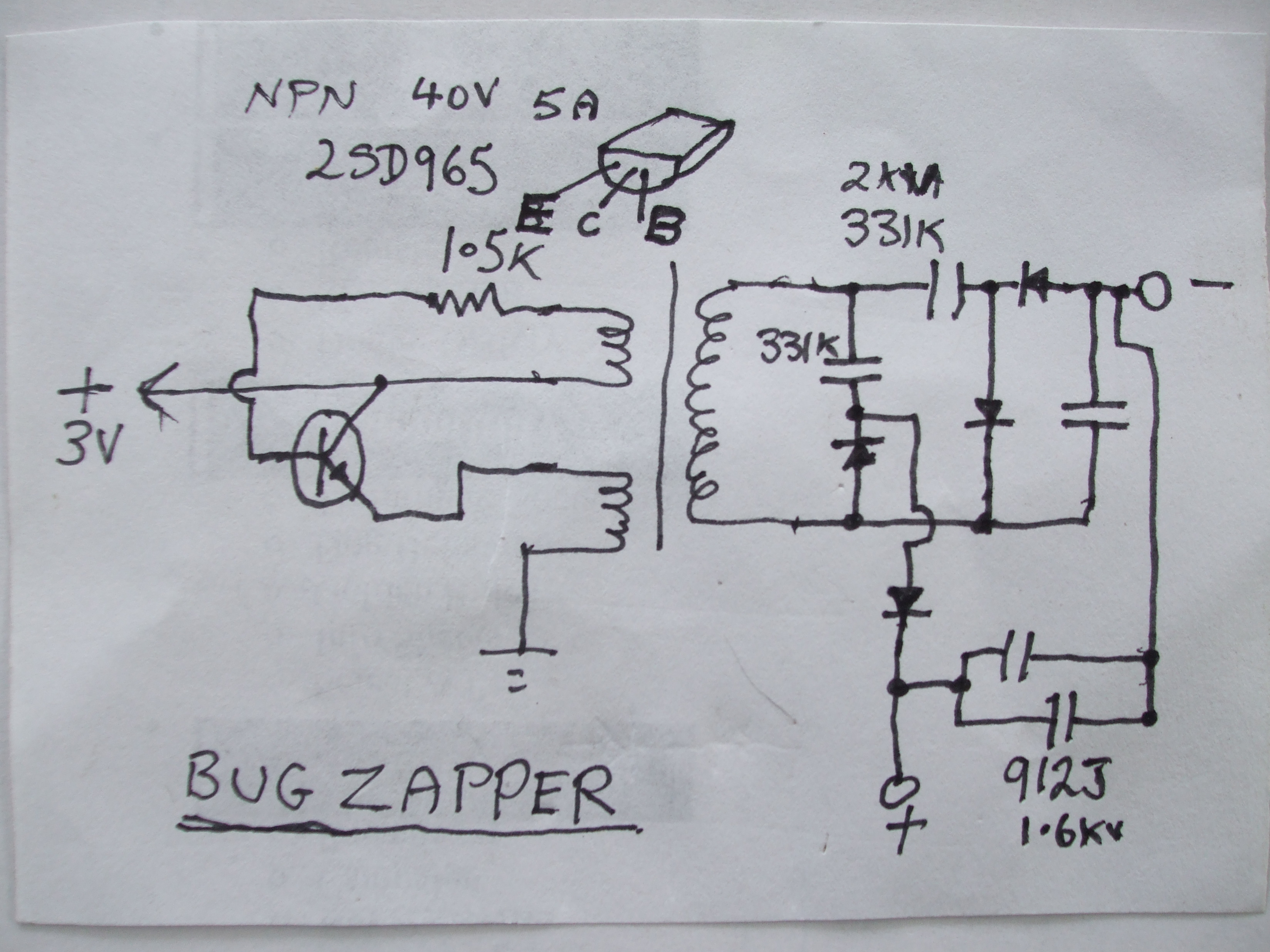

This one is an inverter type using a tripler type circuit for the HV. This is one of those racket type bug zappers.

I tried what alec_t said. When the 555 output is high for 80% the HT is 3.5KV.
I tried reverse the diode and the HT now is -4.5KV. Now I can kill dry flies too.

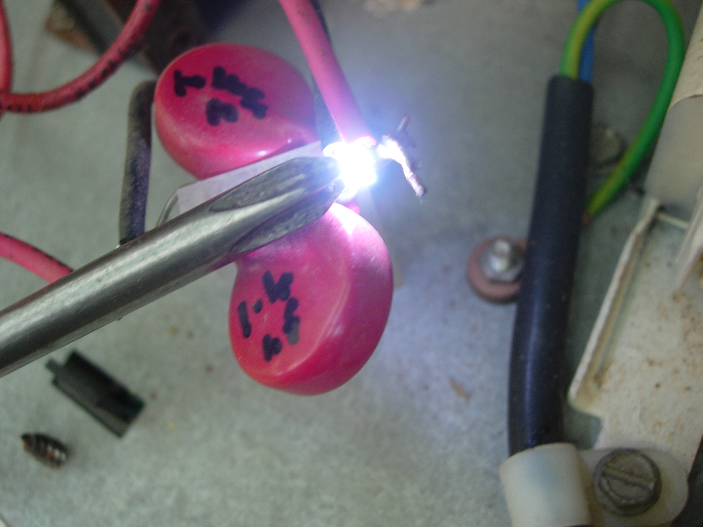

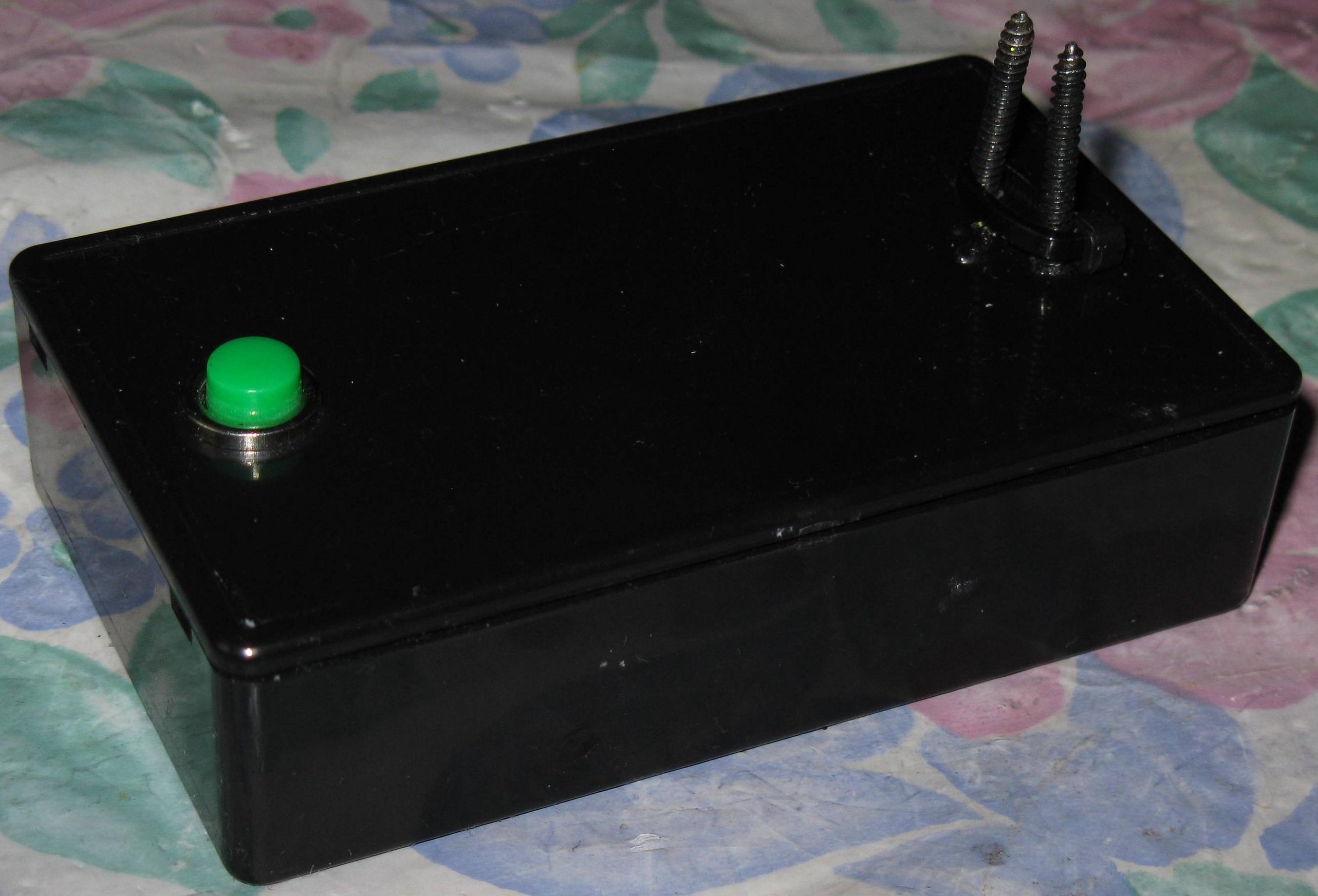

You are quite right audioguru, only mine doesn't have the bleed resistor. I modified one to use as a gas lighter. As long as the button is held down there is a continous arc.
