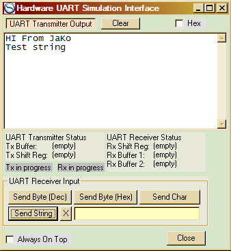

so there's something in RCREG at the startup?
So why is it needed to flush it at the startup? without flushing, it didn't work (I tried it and it didn't)
When you say it didnt work, what exactly happens.??
Post your code.

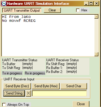

It works fine for me , with and with out your flushes.???
Your PWM problem is some other cause.

So you mean that those three movfw RCREG-s are useless? they aren't needed? than why doesn't it work on my pic? I think that in reality there is something different for which it's needed to flush.
No offense but "in reality" your code is totally hosed.
I'm currently working with your code and making corrections. However, in your TRISB setup you have to set both bits RB1 and RB2 to assign them to the USART. From there the USART handles which is RX and which is TX.
Here is an excerpt taken from the 16F628 datasheet which states this -
Here...try this code -

After correcting the code I removed your other error code excludes besides the error 302. I also test assembled it in MPASM and it assembled fine with no errors returned.
I've also removed the RCREG flush instructions you had in there as well. I then added instructions to check the Overrun and Framing Error flags prior to waiting for the receive interrupt flag upon calling the receive subroutine. Also, I added a subroutine to clear the receive error condition upon a receive error occuring. These flags should be checked and addressed accordingly prior to receiving any serial data as serial receive is disabled upon the Overrun and Framing error flags being set.
I noticed that you're using the internal oscillator. However, serial communications is timing critical and the on chip oscillator may not be accurate enough for it to work reliably. I suggest using an external crystal oscillator. I use the high speed oscillator with a 20MHz crystal, but for the baud rate you're running at you'll probably only need a 4MHz crystal for your project.
