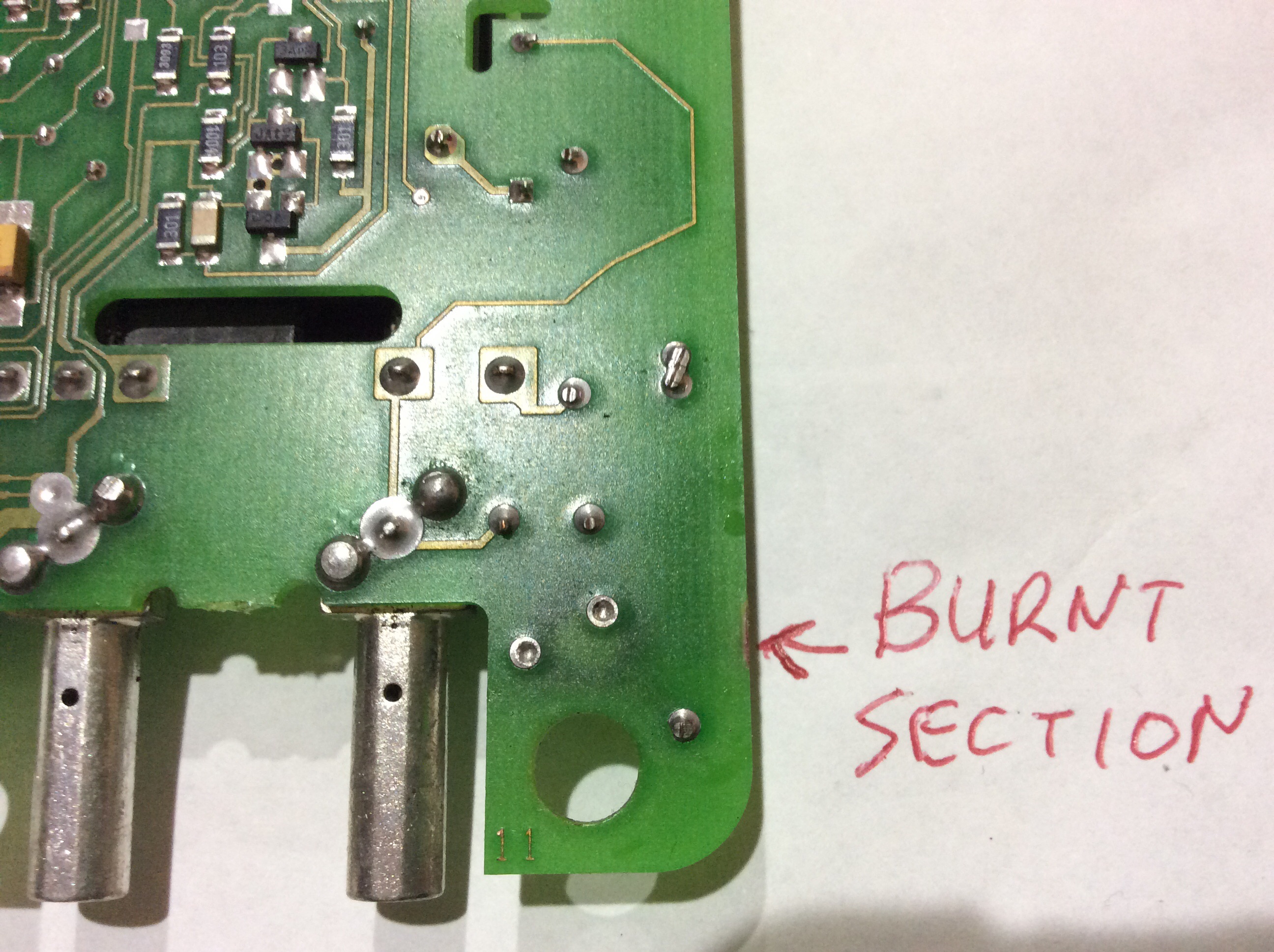

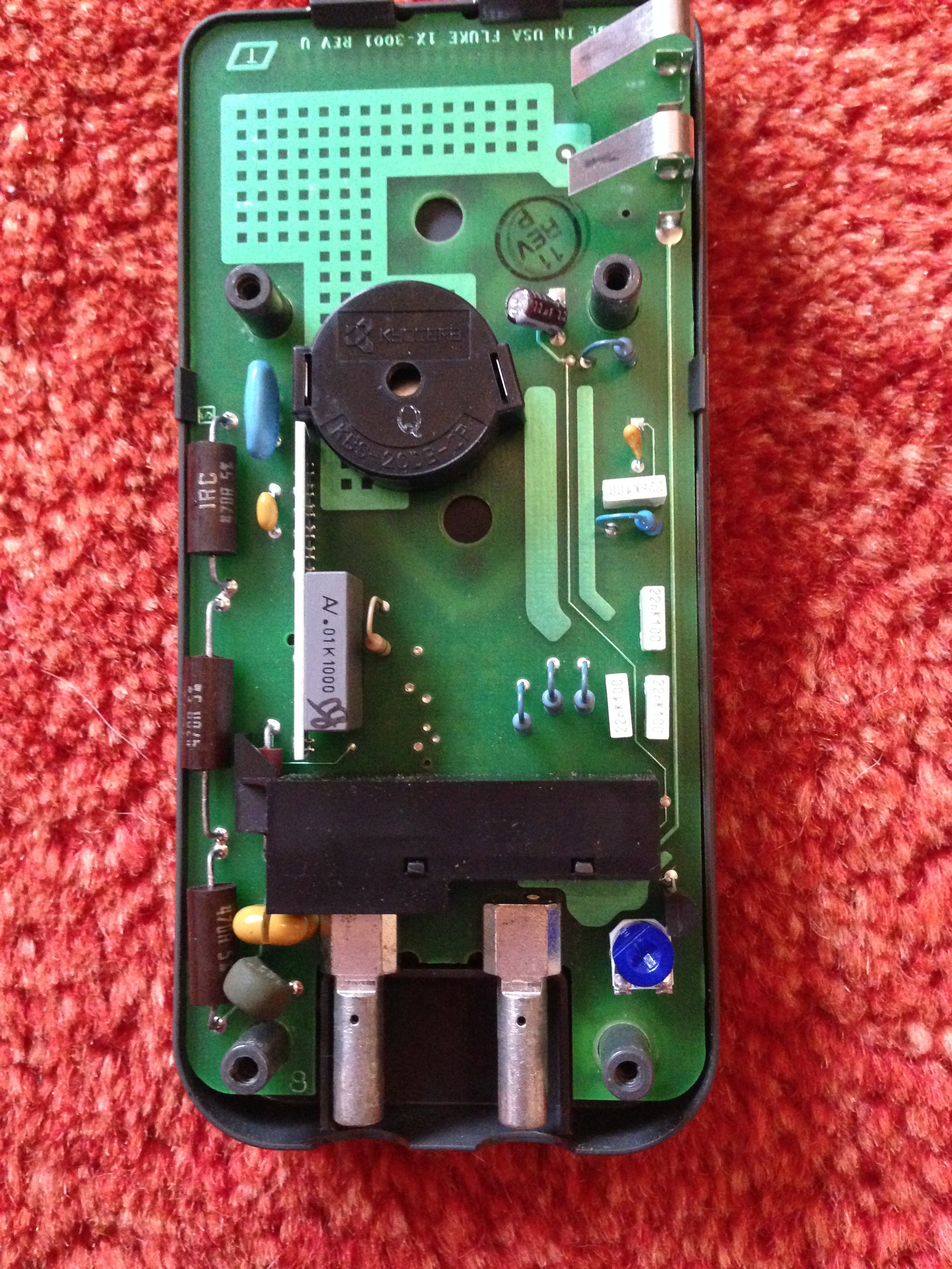

I have a Fluk 12 and have caused damage to the meter . I require a circuit digram or if someone can help me out with the part that is burnt and is there a part missing where the board is damaged or just a track.
Or if someone has one and send me a photo of that area and the part that I need to replace.
Thank you
I have applied to much voltage
Thank you
How do you expect us to find a picture of the area with the damaged component if you don't show us where the damaged component/s is/are? You haven't given us anywhere near enough information to help you.

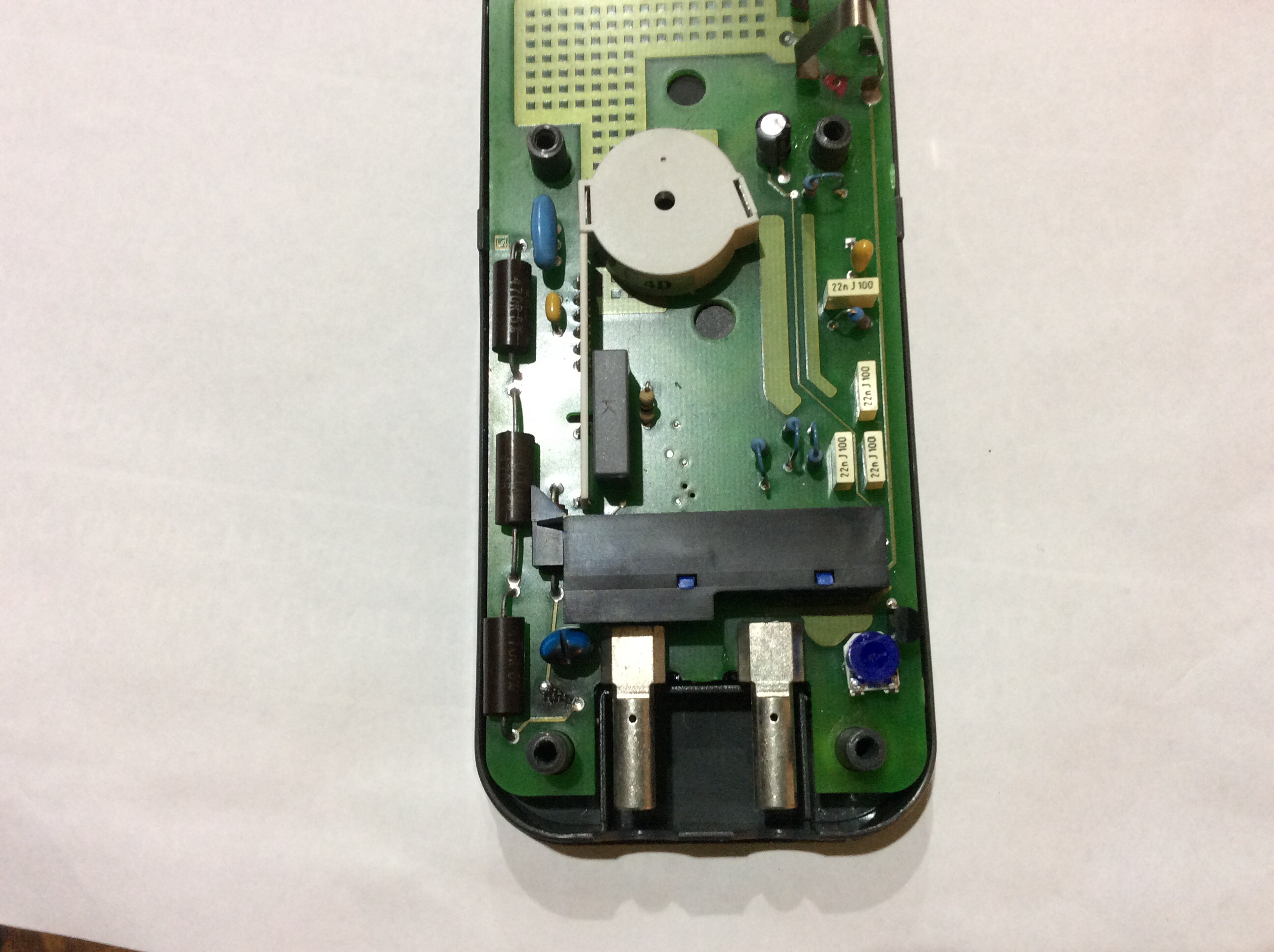

I think you should post a photo of the inside of your meter first.
This is the photo of the

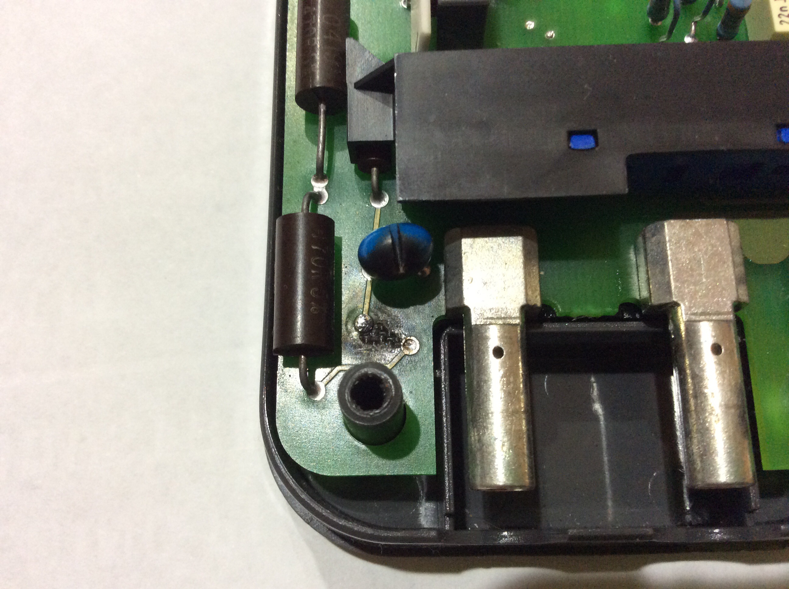

Geez man, how much voltage did you put on this thing???
The blue thing is probably a surge protector rated for 3750V ±20%.
I think there was supposed to be a thermistor (POS, 1.1K, ±20%, 25 C) where the black spot is now, but it doesn't look like it was ever populated. The drawings are a bit iffy, though, so I'm not sure this is accurate.

The HF high-voltage may have arced inside your meter. The chip in the middle of the board labeled, "Fluke" has soot on it. That is not a good sign. It is sufficiently far from the input that the soot probably was not from being a passive bystander, but rather was generated locally. As you know, the HF arc can travel quite long distances. I doubt whether you can buy that chip and whether it is the only problem. You meter is probably shot.
John
Even assuming that you manage to replace the components that are burned, the meter is never likely to achieve the same accuracy again, anything that was hit by the overvoltage/ current will likely be well out of tolerance now. It could never be trusted again. It's a lesson learned to be sure, but if I were you I would buy a new meter and move on.

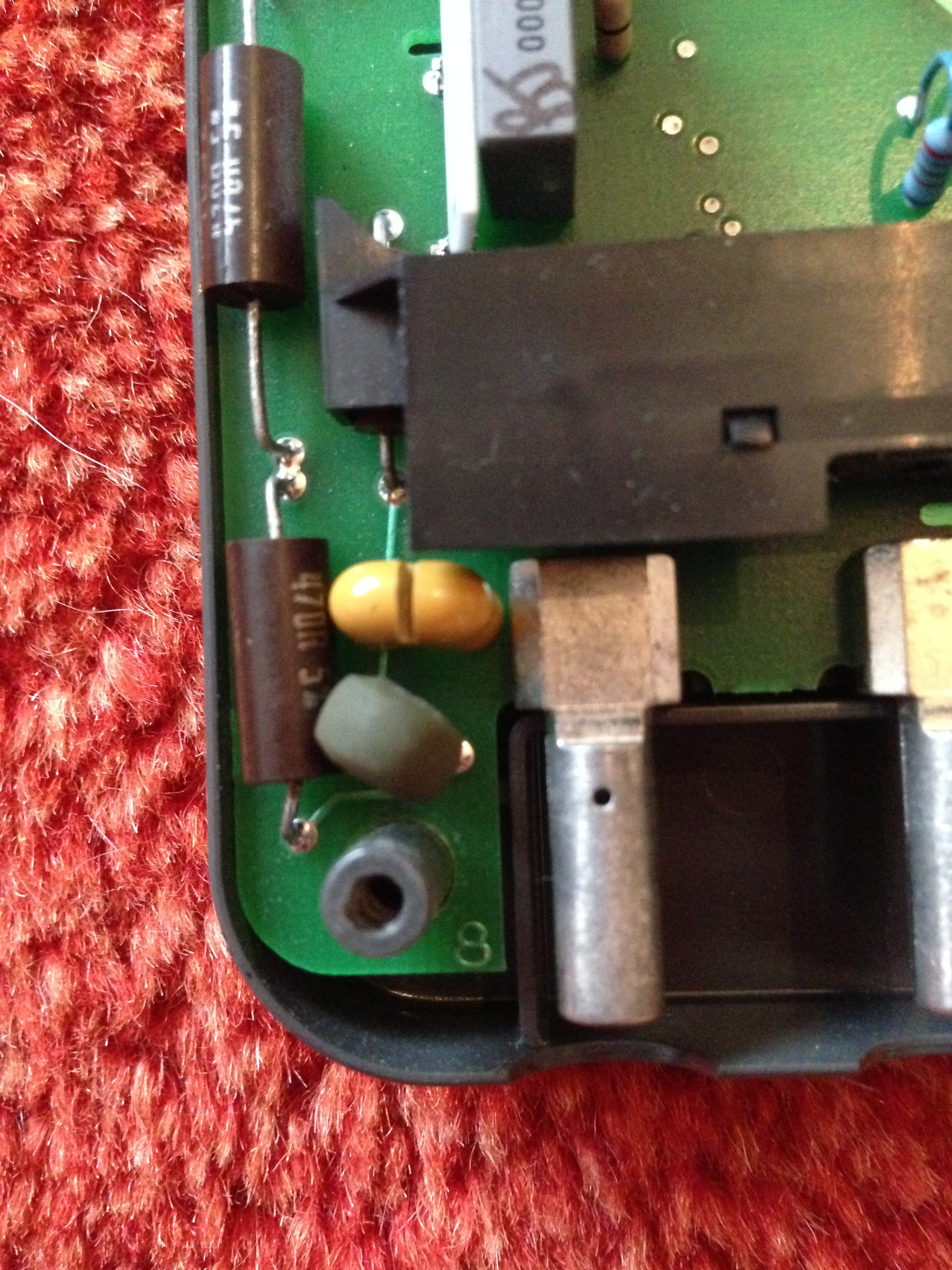

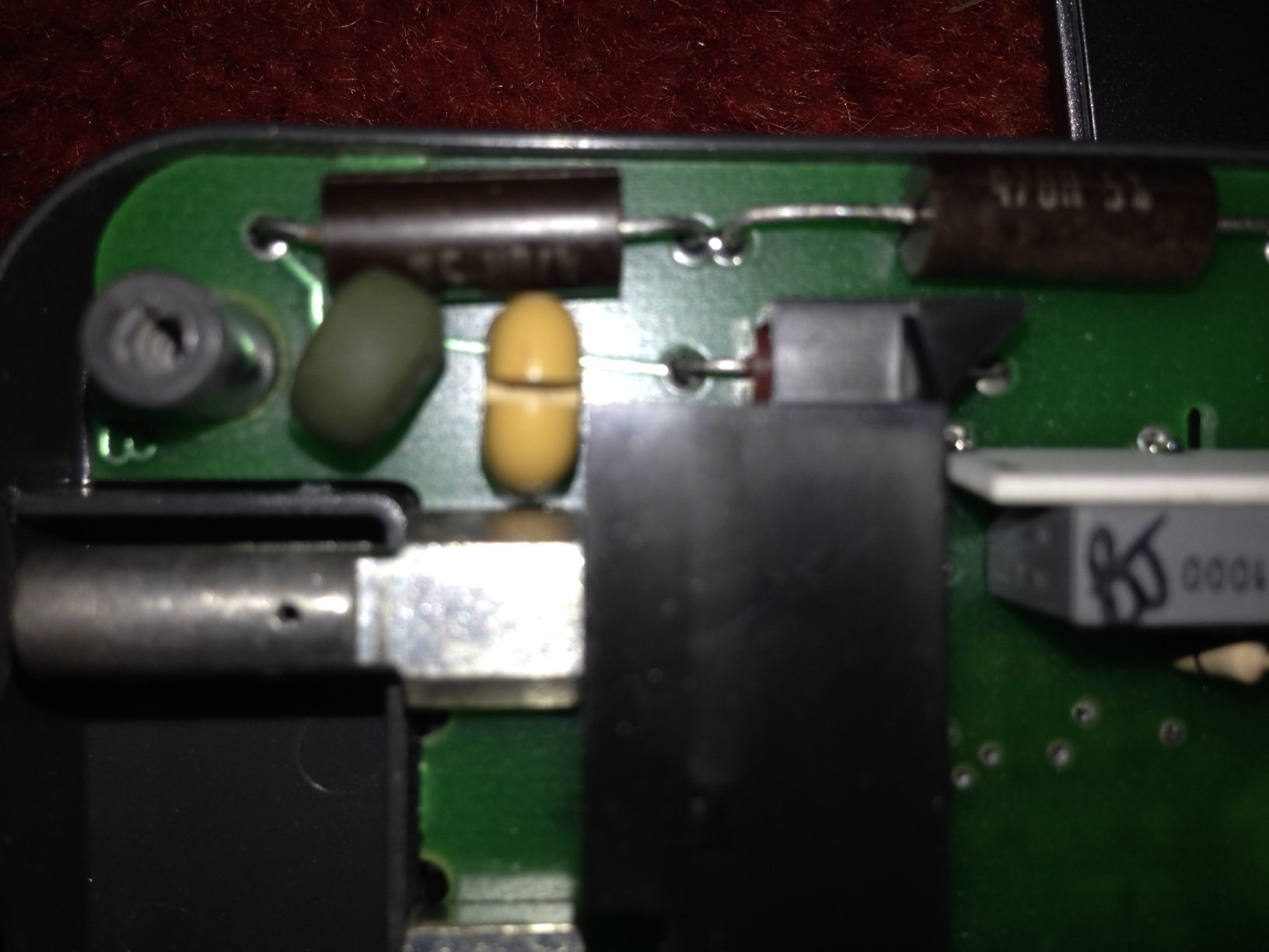

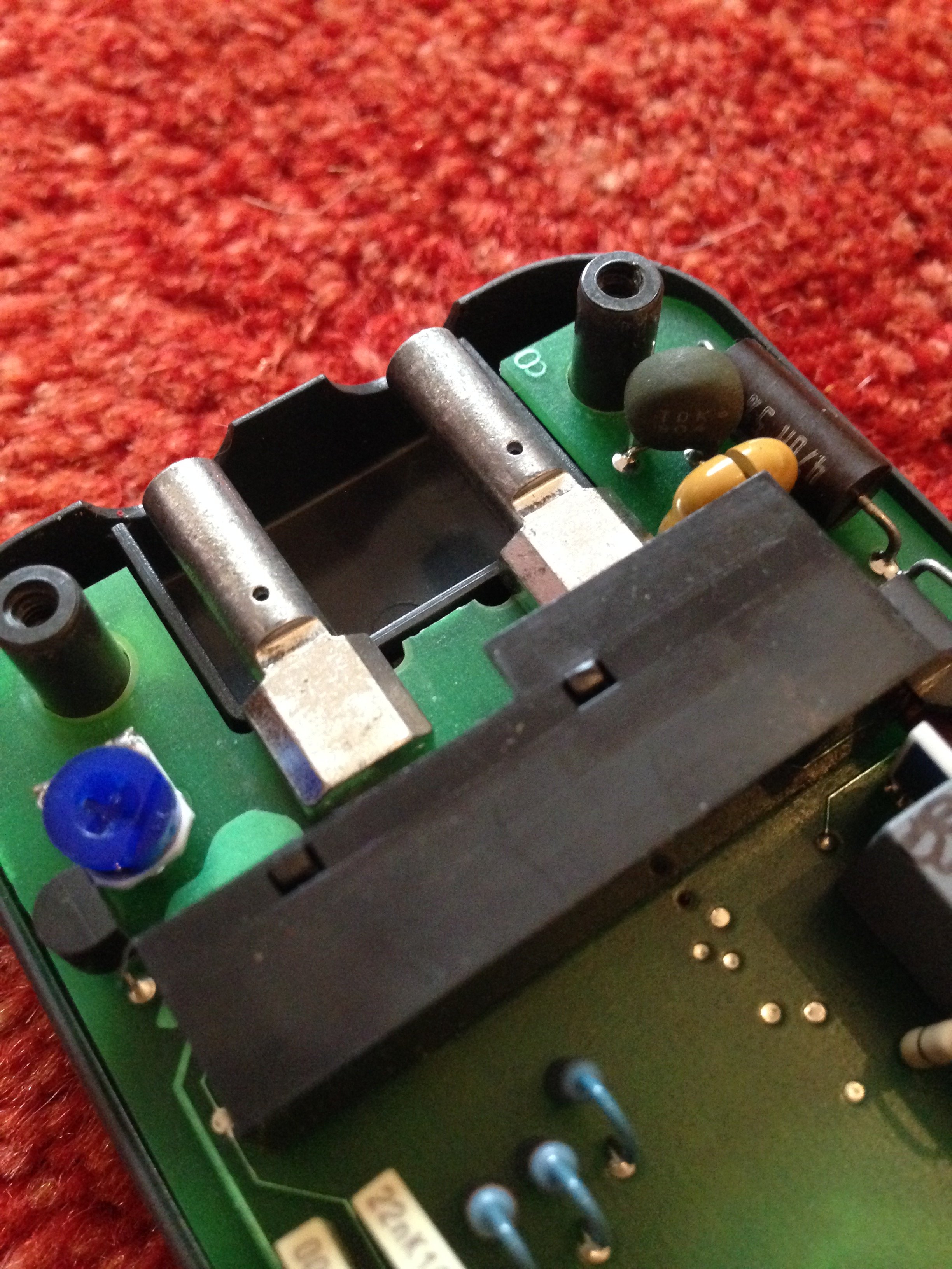

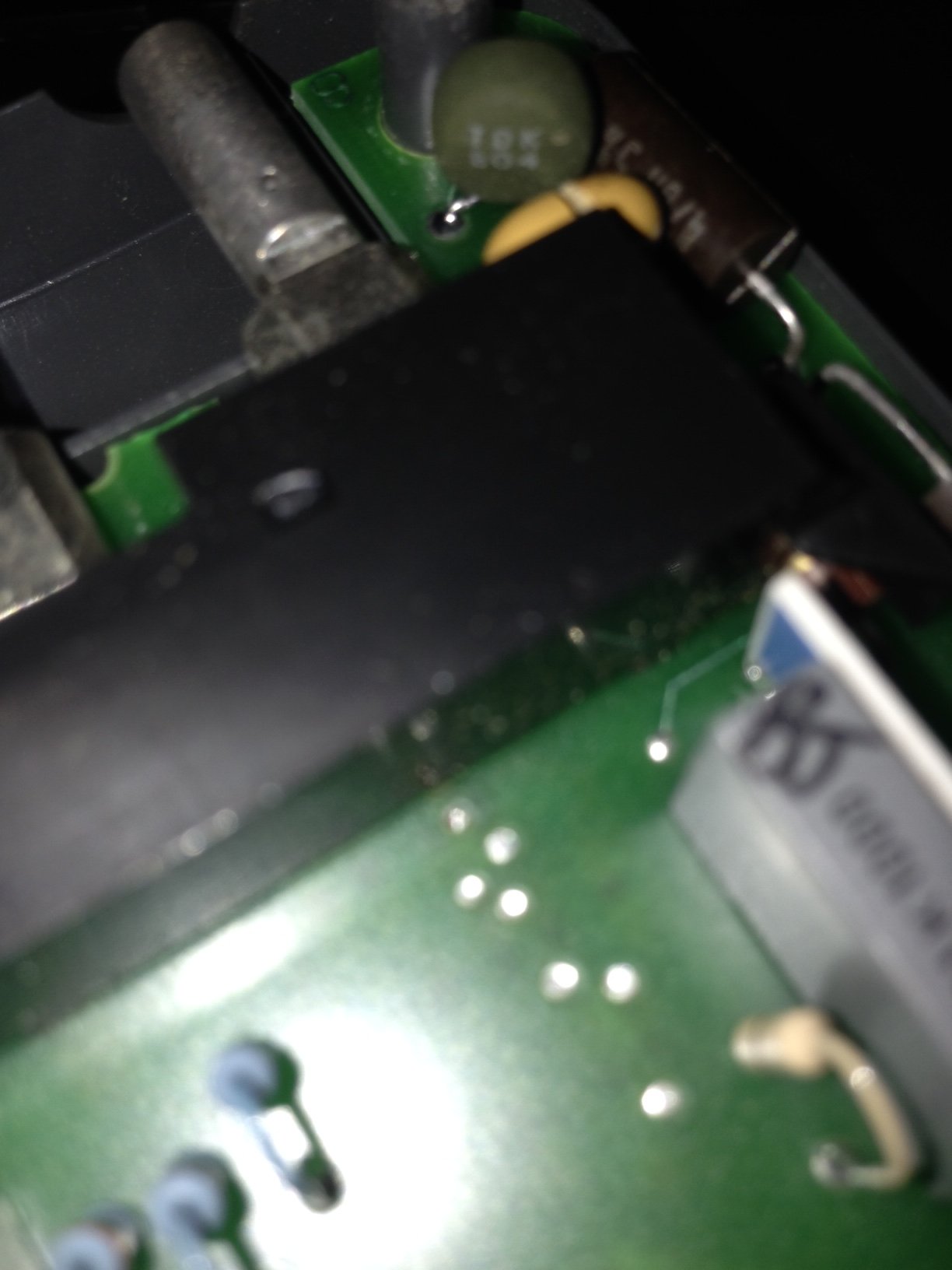

if it helps, i have a fluke 11 and i know that the fluke 10, 11, 12 are built very similar so i took mine apart and here is the part, a TDK804. i am not sure what it is because i am only a beginner and after a google search there was no information on it.
Can you please take some better-focused pictures with better lighting (not washed out)?
Try it without flash and use natural light. Usually works better
Yeah I think the chip with FLUKE on is now slightly mis spelt ;)
