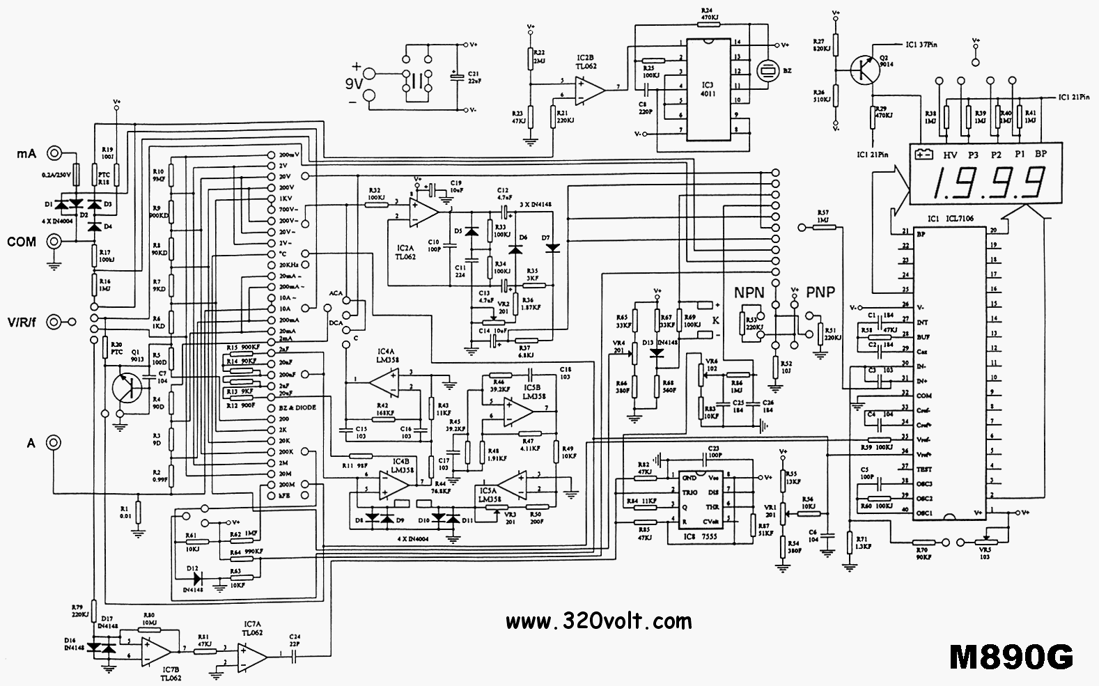

Hello everybody,
i am attaching M890G multimeter circuit from web i found . in this circuit how the ground is created pls any body can explain.
i have tried to measurement circuits with 7106 ic but there should two power supplies we need one for measuring circuit and onother
display circuit of 7106.
but in this a common ground is created pls any body can explain.

Your premise is entirely incorrect - the circuit inside the meter is part of the meter, and MUST have a common ground in order to work.
Your confusion is when building a 7106 inside a project, where it may well require a separate supply and ground - in this case though it's all one circuit, and must be powered together.
Are you asking how to attach a meter to a supply so it can measure a voltage from that supply without having a separate supply of its own? A typical example would be a panel meter that does not have a separate supply in a variable voltage bench supply. If that is the case, the solution to the common ground is to generate a negative voltage for the meter , such as with a 7660 voltage converter.
John
Edit: Here's a link to an Intersil application note that addresses the issue: https://www.intersil.com/content/dam/intersil/documents/an96/an9609.pdf
