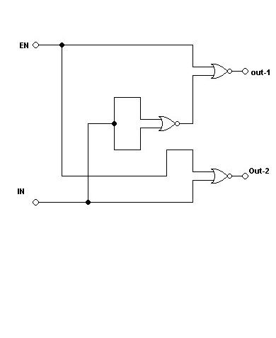

Equal logic function using only single IC NOR gate
why do we go for PIC instead of using a single logic IC??? see the attached file that is an equalent logic for the post by Vne147, but only use NOR gates. you will have a single IC two inputs two outputs and power supply.
Edit: use 4001, Quad 2-input NOR gate
I don't think he should absolutely go with a PIC. I never said it was necessary or even what he should do. I simply asked the OP if he didn't want to use one for some reason becasue a PIC would satisfy his desire to use something with a smaller package. I however still don't think there is anything wrong with using one even if there are other more straightforward solutions available. If board space was very limited, I would certainly consider it.
That's a good solution and a I'll have to admit a better idea than my NOR, AND, and inverter idea but it still uses a 14 pin IC.

If the OP uses a CD4555 it is self contained, does not need 'constructing'
I think the suggestion made by 'vne' regarding a PIC is a valid point, but I dont agree with another posters method of working out the low cost.
Regarding the 'arm wrestling' about the clock, I think we all agree that some form 'external' stimulus is required to trigger the F/F, what ever type, in order to change its output state.?
We have two very clever answers to the problem. A CD4555 or a CD4001. That's the difference between a group of electronics professionals and a group of lawyers. The lawyers will still be working out the $5,000 fee for deciding who will think about providing an answer.
