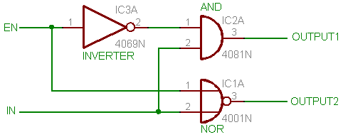

I need a device that should have two inputs - EN, IN - and two outputs - OUT1, OUT2.
It should behave according to the following requirements:
untitled-png.38675
I believe that I need a Flip-Flop, is that right?
Perhaps you could give me an example for such device and spec that i should pay attention to so i could smartly purchase such device?
Thank you.

There might be a more simple method but I think this will work.
logic_circuit_1-png.38678
@Vne
Its actually the exact implementation of the truth table i posted, so its great.
@Eric
Its just the IC i was looking for.
Is it possible to find such IC in a smaller package?
Since I only need only 4 pins after all (2 inputs and two outputs), as drawn by Vne.

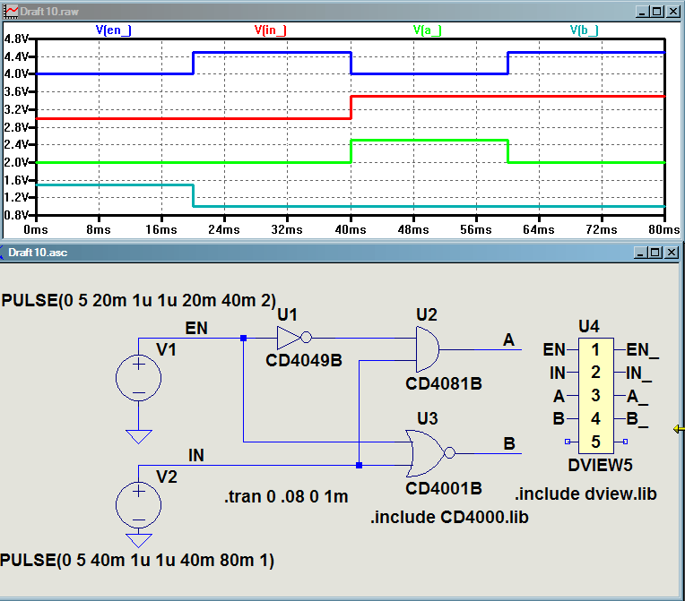

hi vne,
This is your circuit in a LTS sim.:)
Thanks for verifying.
