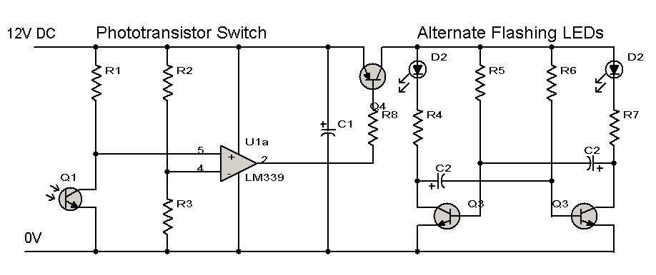

Tis me again. I've got two schematics of two seperate circuits, one that turns an LED on using a photoresistor and LM339, the other is to flash two LEDs alternately.
Both work individually although not knowing too much I have no idea how or why.
The thing is I want to turn on the flashing LEDs using the photoresistor when 'darkness falls'. I've had a go at a schematic using a transistor to switch the second circuit on, guessing how the two circuits would fit together.
Can someone take a peek at the schematic and give me the ppropriate nudge in the right direction please.

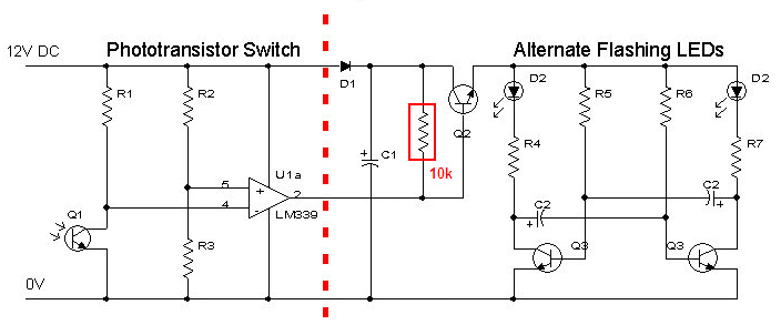

Look at the datasheet of an LM339 quad comparator IC. Its outputs are the collector of an NPN transistor. An NPN collector can sink current to ground but cannot source a positive current that is needed by the base of Q2 for it to turn on. Add a 10k resistor from the base of Q2 to the positive supply to turn on Q2 when the output of the comparator goes high.
You have the inputs of the comparator connected so that light on the phototransistor will cause the alternating LEDs to light up. Reverse the connections for the alternating LEDs to light up when it is dark.

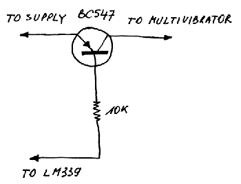

NPN transistor.

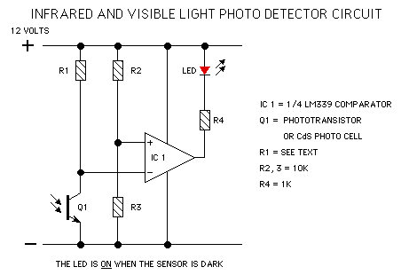

But I have the first part of the circuit as a seperate entity and instead of the transistor to the second circuit I have an LED with negative leg to the 339 and that lights up when it goes dark. While I don't question what you're saying I just don't understand why.
Ah, That's because the program I used to do the schematic had the comparator that way up and I didn't engage the brain when I inserted it and joined it up.
However, that little gem has helped me gain more knowledge in this, the mere fact that it can work in reverse :)

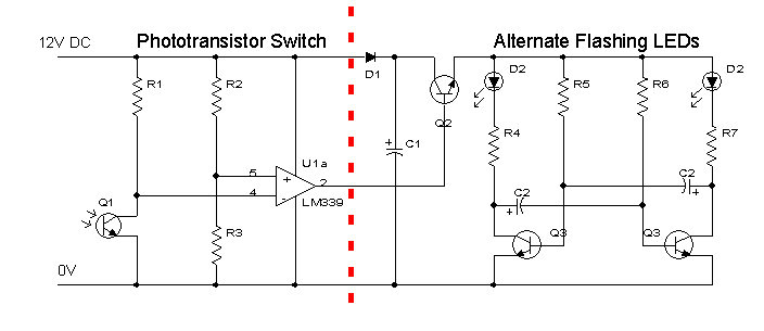

angie1199 said:
And now it's the right way?
No. You swapped the inputs of the comparator but you also swapped the NPN transistor that didn't invert to this PNP transistor that inverts because its load is at its collector. So the LEDs light up when it is light.
So change one or the other and not both?

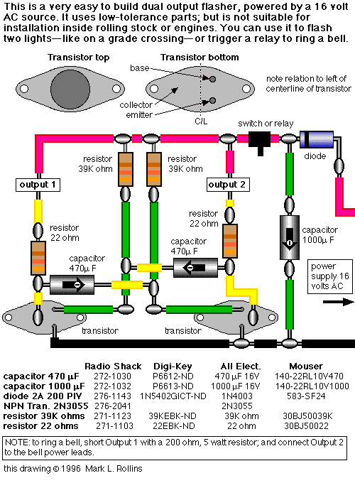

And the two transistors at the right for flashing the LEDs. I know LEDs are small current but the circuit I used said to use a 2N3055 which is 15A. Is the author of the circuit simply being 'over cautious'?
No, if it used 2N3055's it was for a specific purpose, and it WASN'T flashing a couple of LED's - what's the URL you got it from?.
BTW, that part of the circuit is an 'astable multivibrator', a very basic circuit

The huge 2N3055 transistors are used to flash powerful car lights, not LEDs, or ring a powerful bell.
This very simple circuit isn't for 3rd year colege, it is designed by sombody who never went to school.
