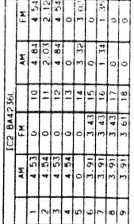

Think I figured out what the voltage chart was (inserted a small piece of it in this reply, I found the correct one, right?) So far Ba4236L is measuring some really odd/small numbers when I measured it on Fm. pin 7 measured between 5-6 mV. Didn't find anything indicating whether the chart was in Volts or Millivolts, but the numbers seemed off nonetheless. I'll be measuring the rest of the chips tomorrow, I'll also test + clean the switch while I'm at it.

that chart is in Volts. you need to find a ground point, such as CN1 pin G. on CN1, pin B is the power for the tuner, and should be around 5.5V. that voltage originates on the amplifier board at S302-5. Q305 is the voltage regulator for that supply voltage.

Alright, I looked around and at first there was no voltage going to both pin B and ground. However I managed to solve that as I found what would be a factory error on the main PCB (Which seems to have followed onto one of the schematics in the PDF file, PDF page 16.) According to page 17, There was supposed to be a path from S302-5 Pin 2 that should go directly to tuner radio pin +B supplying, as you said, 5.5 volts to the tuner. It was also supposed to split before reaching the tuner through D304.
I found D304 using page 16 and started to look at my circuit board to figure out where the path to CN1-B was located (as I was measuring .300 Megaohm from the switch to CN1-B, so the path was broken). The resistance being measured was from D304 to CN1-B. I started to troubleshoot where the split "clean" path towards CN1-B was supposed to be and figured out there was actually a missing component on the PCB. (Pictures here: https://imgur.com/5sIEdz0 and here is a picture of my repair: https://imgur.com/VmK4H9m). As seen on the first picture, I was pointing towards the missing component which was supposed to bridge a gap and then go straight for CN-1 B. It's said "bridge" that was non-existent on PDF page 16.)
I added a wire as seen in the second picture and that seems to have solved the no-voltage problem. I can now measure a steady 5.5 Volt between CN1 pin G and ground.
However, the radio is still not changing channels. but atleast now the tuner board is receiving power. I also noticed an increased amount of hum from the speakers (Perhaps now I'm picking up a signal, but am unable to change what frequency?)
I'm going to measure the voltages going towards the different legs on all the chips and will return once I figure something out.

Thanks for the help! Managed to fix the problem and everything is working fine now. added what I did to my post.
