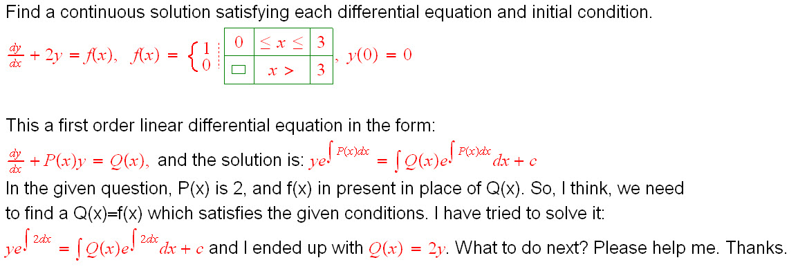

Hi
Please have a look on the attachment and you can find my query there. Please help me with it. I'm much obliged.
Regards
PG

PG,
For 0 ≤ x ≤ 3, y'+2y=1, so the integrating factor is e^∫2dx = e^2x. That gives y'e^2x+2e^2x = e^2x, or (ye^2x)' = e^2x. Integrating both sides gives ye^2x = e^2x/2 + c or y = ½ + ce^-2x. Substituting the initial conditions gives 0 = ½+c ==> c = -½. So we have y = ½ -½e^-2x for 0 ≤ x ≤ 3.
If x is outside the above range, y'+2y=0, the variables are separable, and the solution is easy.

MrAl,
As I understand the problem, if x > 3, then the differential equation is y' + 2y = 0 ==> y' = -2y ===> dy/y = -2dx. Integrating both sides gives ln(y) = -2x + c ===> y = e^-2x+e^c = ce^-2x. The initial condition cannot be applied here because y(0) is not defined for this solution due to x > 3.

Hi again Ratch,
I was hoping you would notice that we can't apply the initial condition y(0)=0, and i wanted the solution to show exactly how it was done, thanks for that reply.

Interestingly, the new initial condition can come from the first equation solved for 0<=x<=3 . Since we solved for y we can set x=3 and get the new initial condition.
If you'd like to try this solution it might be good to see the complete procedure here.

Not really. y=e^(-2*x+c) has the same form as y = C1*e^-2x, and both solution forms will satisfy the differential equation.
Yes, I thought about that after I submitted the post. That will certainly give continuity to the curve. The equation for both curves will meet at about y=0.5 at x=3. The solution for x>3 will then be y = (½e^6 - ½)*e^-2x

Many thanks, Ratch, MrAl.
I didn't come back to the forums for almost last three days that's why my thanks are little delayed. Yes, I understand it now.
Best regards
PG
