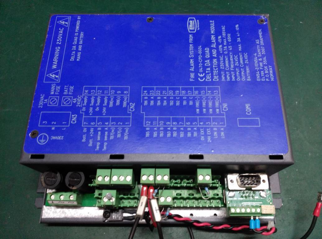

I´m trying to repair an Eltek fire alarm unit controller. There is no communication between the display unit and the other unit where all sensors are connected.
I have not experience on this unit but checking the power supply where I should get 24V I´m getting 30V so I´m thinking about the possibility of having problems at power supply and due to that the system is blocked, detecting to high voltage value (it is only an idea).
The main IC from the SMPS is an UCC3804. I have checked the feedback pin is ground connected and at Comp pin I have 1,24V. I tell you this because I thought about the possibility of having some problem at feedback circuit getting the maximum output voltage at SMPS. The Comp pin is connected to the transistor part from a HCPL354 opto at collector and emitter directly to ground. In theory, that should control the stability output at power supply.
I replaced the opto swapping with another on the board. Same behavieur. Measuring at pin 6 I have 45,8KHz PWM pulse.
Any idea why do I have this high voltage output? I think that is not normal. As always not schematics available.

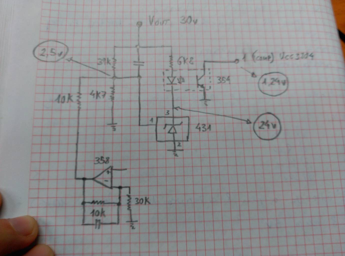

No voltage divider. I made the schematic from feedback circuit so output is directly going to a 431 shunt regulator.

I was thinking about that but after the main output there are some other regulators as LTC1624 which is not switching, I guess because it detects too much voltage difference. As you can see in the schematics I took some measurement and the voltage at shunt regulator is 24V. I would say it´s prepared to supply 24V.
I still have to connect my power supply to see what happens, there is an optocoupler feedback from primary side going to the microprocessor too, so may be I have to supply some signal there.

Pin 2 is directly connected to ground. Pin 8 is 5V. If I measure at diode from optocoupler I see 1,052V this means the 431 is conducting, but if I measure at the transistor from opto I measure 1,24V which I guess it should be less to regulate the PWM.
As I said I swapp already the optos with same behavieur and I replaced the 431 with not successful.
I have tested the resistors and I don´t see anything wrong.
What about pulling down a little bit the pin 1 voltage to modify the power supply output?

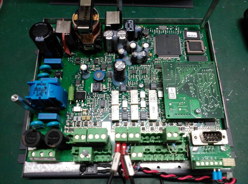

About this unit I was focused on power issues before checking communication things. As I told you there are more dc-dc on board, for example a LTC1624 which was not working...
About communication I guess it uses e-bus which I didn't check exactly what it is, it could be RS485 as it uses 2 wires.
Thanks Dr Pepper, I'm agree with you. I have in mind to change como pin voltaje through a variable resistor just to see if output changes.
I have not enough time because I've been repairing other units too and next week I start a job installing a MTU electronic system in a Yacht, which will take a lot of time in the field. Tooooo much work!!!!
at LTC1624 I have 9V at pin 6 and 30V at pin 8, I should have PWM signal instead of 9V. At board there is also a MC34063 which should step down to 5V but I have nothing at pin 2. Measuring at chip out of board resistence between pin 2 and pin 4 I have 35 ohm which means the IC is damaged. If I measure at pin 2 at board without the chip I still get 43 ohm which is very low value against ground. I powered with 5V and I get 250 mA so now I´m not sure if that value is normal or is too high. It seems the power supply is overloaded so it gives too much voltage at its output due to 5V line problem.
When I give 5V I feel an IS62C1024AL a little bit hot but not sure if that is a problem. It´s a static RAM, what do you think about these values? I shouldn´t expect 43 ohm at 5V line...
I have lift the power pin from the static RAM and resistence at 5V line went to 3K7 ohm so measuring at chip itself gives me 122 ohm...

after changing the MC34063 and the IS62C1024AL power supply worked right and equipment start working again with 5V, 24V and the rest of voltages. Thanks for your help and ideas.
