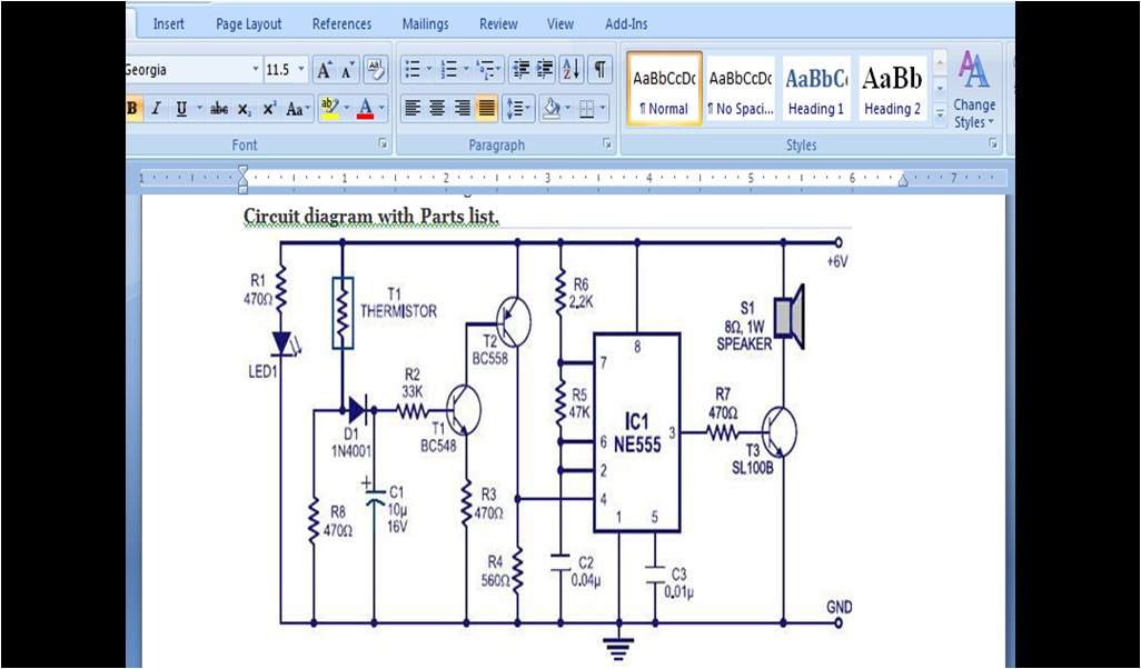

hello is der sumbody know how the circuit flow in this fire alarm?and also all d conditions on how the circuit behaves??? i got this circuit @ **broken link removed**

What part of the provided explanation are you not understanding?
Circuit Operation:
Timer IC NE555 (IC1) is wired as an astable multivibrator oscillating in audio frequency band. Switching transistors Q1 and Q2 drive multivibrator IC1. The output of IC1 is connected to NPN transistor Q3, which drives the loudspeaker (SPKR) to generate sound. The frequency of IC1 depends on the values of resistors R6, R7 and capacitor C2. When Thermistor TH1 becomes hot, it provides a low-resistance path to extend positive voltage to the base of transistor Q1 via diode D2 and resistor R3. Capacitor C1 charges up to the positive voltage and increases the ‘on’ time of alarm. The higher the value of capacitor C1, the higher the forward voltage applied to the base of transistor Q1. Since the collector of transistor Q1 is connected to the base of transistor Q2, transistor Q2 provides positive voltage to reset pin 4 of IC1. R5 is used such that IC1 remains inactive in the absence of positive voltage. D2 stops discharging of capacitor C1 when the Thermistor connected to the positive supply cools down and provides a high-resistance (10k) path. It also stops the conduction of Q1. To prevent the Thermistor from melting, wrap it up in mica tape. The circuit works off a 6V-12V regulated power supply. D1 is used to indicate that power to the circuit is switched on.

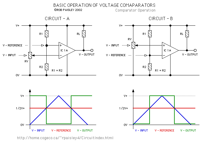

better to use comparator then 555 chip start with 741 op-amp.
make Wheatstone bridges measure input terminal with multimeter( + and -ve of amp inverting and non-inverting)
add series resistance with the input as:
R1 + Rrse....
a changes in thermistor resistance will change output due to op-amp high gain...!!

This link will help explain what RITESH KAKKAR is getting at with the use of comparators. However, the original circuit using the 555 as an astable multi-vibrator drives a speaker for an audible alarm when the temperature limit is exceeded. The comparator circuit method would require an audible device and driver. Based on your original post I believe you are learning in the early stages?

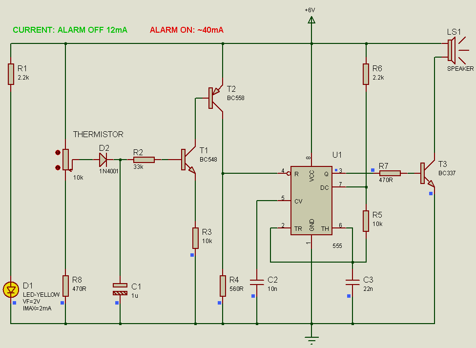

The circuit will be silent if there is no fire.
With the given values the alarm will sound at 300Hz. Changing the values as of the attached circuit the alarm sounds at approximately 3KHz.
Current consumption is about 10mA if you use a low current LED as indicated in the schematic.
Current flow will increase to approximately 40mA when the alarm is activated.

The circuit does not sense fire or smoke. It senses heat so detection of fire is by sensing heat. When there is no heat exceeding a preset limit T2 is off and pin 4 (the 555 reset pin) is low so the 555 is inhibited from operation. Thus no sound. The frequency of the sound can be changed as Boncuk mentions. The 555 functions as a astable multi vibrator so when it is on there is sound and when it is inhibited (Reset low) there is no sound.

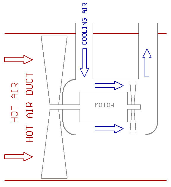

I understood your point fully, having been working in the field of air movement in large buildings for 18 years. Smoke venting is very important without any doubt and that's why I used smoke venting fans which have been tested to run for three hours (encapsuled with active fresh air cooling) at temperatures of 600degC.
However, the subject is fire alarm, which can be triggered by extremely high ambient temperatures. Not every hobbyist can afford a smoke detector and that's certainly a point to think about as well.
Here is a drawing of a smoke venting fan.
