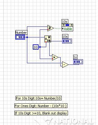

Whats the best way to display the individual digits of a two digit number? Im sure that Ive gotten the display routine down, but I have to figure out how to extract each digit from a dual digit number. I want One display to display the 10s, and the other to display the ones. Eventually this will be used in a PIC micro to display data Via 7 Segment Display or BCD.
This is what I came up with in Labview, but I think theres a simpler way to do this:
digits-jpg.22894
Number is the Incoming number, 10s is the 10s digit and 1s is the ones digit. It works, Except for Negative Numbers. If I need to display Negative numbers, I can only display digits -1 to -9 (two digit display, left most display will be the negative sign).

Well, if the number is a true binary number and not binary coded decimal (BCD) then shifting or swapping and masking is not going to work.
You are correct that you get the tens digit by dividing by 10 and taking the integer result. The remainder is the units digit. It can be obtained as you have by multiplying the tens digit by 10 and substracting from the original number. It can also be obtained by calculating modulo 10 if there is a modulo function.

There a operator called MOD, thats under mathematical functions, but I dont know what it does.

Why not try it and find out. It probably takes two arguments, the first would be the number you are working with and the second in your case would be 10.

Said Thread gave me a couple Ideas, so Now Im looking through Math.bas (a bunch of math functions). Theres a function that truncates the decimal of a number, ie 2.7 --> 2. Thus for the 10s digit I can do this (and it works for negative numbers):
pseudo code
Digit = Digit/10
truncate Digit
Display Digit //10s digit
1s digit will probably follow the way that I did it in labview.
ADD: Even better Idea, two Digits will allow me to go from 0 to 99, so what if I use a "rectangular" led to indicate a negative? It would save On Code, and I could use a simple if statement to determine if the number is positive or negative
