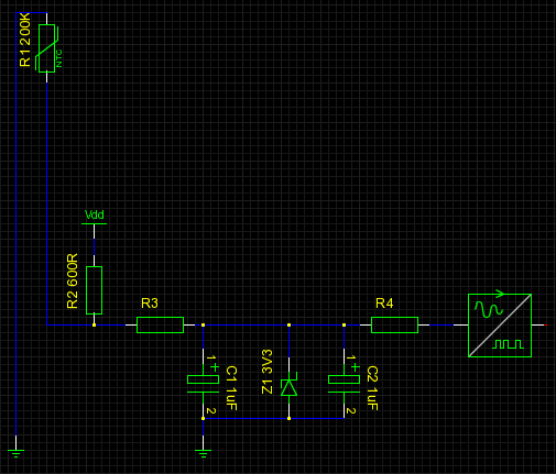

the idea with op-amp was - I put the mcp602x into a socket and if it dies, I throw it away and put another one :), but I kinda believe the spike won't go trough it... that was the idea anyhow .. but looks like it is not needed (reading all the suggestions here) and that my first idea, that I scrapped as "not good enough" is the way to go?! I attached the initial idea how to solve it (the one I gave up on) - I changed the capacitors to 1uF (initially there were 100n), any suggestions for the R3/R4 values?

For the resistors you can't go too high since your going into the ADC, but I would start with 1k each and move up to 10k. I'm going to guess the supply for the MCU is not the same as the supply for the heavy machine. You may be also getting some heavy ground bounce (which the TVS won't help with). If this is the case you may want to look at heavier isolation (even optocouplers). At that point having some OPAMP would help, since there are some which are built for this type of things.
I was thinking about 2k2 for both of them but .. I'm still not sure if this is going to be enough protection...

Well, if you haven't tried it yet; then use the 2k2 resistors with the TVS and caps as per your illustration. Out of curiosity, what TVS are you using? Do you have access to an oscilloscope that you can look at the signal going to the MCU?
Ah, I just had idea to do it like that, then decided it's not going to be enough and thought of using op-amp and then I wrote the message here ... so the machine is working with R1 (ntc), R2 (600R) and C1 (100nF) only attm. I do have a scope but the problem is that the signal looks ok for hours at a time so this is not something I can easily catch. I did leave scope running on single trigger once and it did record a spike and the machine was frozen ... but as I mentioned catching this is not simple as I don't have this sparks all the time (nor I have some fancy scope, just on picoscope usb small one and one gw-instek dso so looking for this type of spikes is very hard)... I think I'll try it with 2k2x2 and 3vX zenner, those I have a lot in the house ... in combo with 1uFx2 might get the job done. If you have some suggestion (farnell part number for e.g. :D ) for the TVS, don't hold back :D I only have some in 250+V range so I'll have to purchase them anyhow if I'm to use them.

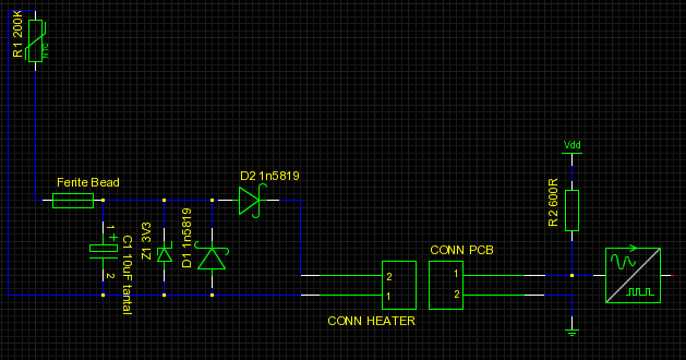

mosaic, thanks for the info ... I think I will go with schottky and zenner for start as I don't have any tvs at home + this design (if works) will solve the problem without modifications of the current system (both sw and hw). I don't know what the voltage drop will be on the D2 considering it is Schottky and that ADC don't pull much current, so it should be close to nothing but if it is significant I will remove D2 and try with rest of the circuit only... if it does not help, then a more serious thing need to be done as I should solve the problem without having to modify existing board (as many are made, and this protection is part of separate "Break-out board" connecting to original one.

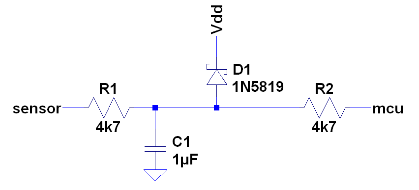

Depending on your supply, you could connect the fast diode (low dropout) to supply directly (as shown on attachment). This is what most of our low-cost products use. We do use TVS for heftier protection (and when power supply can't take surge - such as lightning applications).

What's the importance of D2...do u expect -ve going transients?
The circuit u have there is wrong.
The schottky (fwd bias) is in series with the zener (rev Bias) and this series pair is placed across the ADC/ground lies.

Even a 100V transient on the 27k would be cut to 25V by the voltage divider...which calcs to under 1 mA current for the MCU clamping diode to handle.
Resistors are your friend vs transients.
