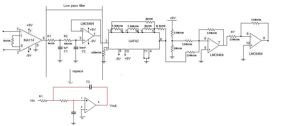

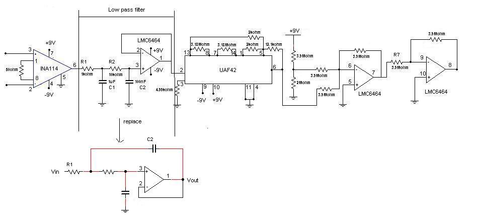

Hello.. i have 1 problem that relative with the low filter (Before i have post 1 topic about the ECG system) and i want to change the circuit for the low pass filter... before i am using the 150Hz for the low pass filter and now i want change it to the 60Hz.. But after i changed the value of R1 (to 2.65kohm) and R2 (to 26.5kohm) i cannot get the ECG signal
Before chaged the value, the signal very small after i pass through the notch filter, why??) i am using the formula : 1/2*pi*f*c to change the value for LPF.. Any mistake in the calculation??
Em.. i also want to change the previous circuit (low pass filter part) to butterworth filter using sallen key circuit for improve my circuit performance.. But i dunno how to what value should i put.. Can u help me put the value?? i want set the frequency at 60 Hz and 120 Hz..
The last question is the connect to replace the LPF part is correct?? i have upload the circuit below..

Does your ECG signal have a 60Hz component to it (not noise but actual) ?
Be sure you do not filter part of the signal you need.
And hows come the inamp is not rejecting all the 60Hz? Its CMRR should be fantastic at 60Hz.
Also the equation you used, I have nto figured out if it is correct or not for your circuit but in any case, keep in mind that these pole frequencies are actually 3dB points. The filter has slope on both sides of the pole. In otherwords, a 60Hz LPF for example, actually begins rolling off down at 6Hz..
Hi Kingkong,
Your hum pickup is caused by poor shielding of the cable, and as said before, the shield should be driven from another opamp. See the inamp's datasheet.
Your original lowpass filter is just two cascaded RC filters so its cutoff is very slow and droopy. With your new resistors of 2.65K and 26.5K, its response at 60Hz is -6dB, which is half the voltage. Not much difference. Its slow and droopy response even cuts 6Hz a fair amount, so your 15Hz to 30Hz ECG signal is also being cut quite a lot.
Even if you use a 2-pole Sallen and Key lowpass filter, 60Hz won't be cut very much but your ECG signal will still be cut.
The Q of your notch filter is probably much too low, so it is also cutting your ECG signal. Get rid of the notch filter, it won't reduce the harmonics of 60Hz anyway.
I suggest that you use a switched-capacitor Butterworth lowpass filter IC, I used a 4-pole National one to filter all the harmonics from my sine-wave gen, but it isn't made anymore. Maxim make some good ones, even with a built-in oscillator. With a cutoff frequency of 30Hz, a Butterworth 4-pole filter will cut 60Hz 24dB, which is 1/16th of the voltage. Harmonics will be cut much more. The 15Hz to 30Hz ECG signal will barely be affected.

The inamp has a gain of umpteen-thousands so its CMRR is probably nearly the same, and the probes will pickup some unbalanced hum anyway. It needs good shielding and filtering.
1. You have pins 1 and 3 swapped.
2. The inverting input should connect to the output, not to GND.
At what frequency do you want to set the -3dB corner, and why? Are you planning to keep the notch filter?
I, like the others, suspect that you still have not properly connected the shield on the cable, as shown in the schematic.
Actually in the output of filter is just sin waveform.. After the signal pass the notch filter i will able to see a little bit ECG waveform..
The Q of filter is low so i think i will put it up.. What walue ar u suggest audioguru??

i already follow what the datasheet mention and add the op-amp already.. But still the same result..
Ron H.. Which part u mention?? Can you point it out??
The freuqency is 60Hz and want try to remove the above frequency...

See revised schematic below.
A 2 pole Butterworth has a slope of -12dB/octave above the corner frequency. If you want to reject 60Hz, you will have to set the corner below that. I think someone else pointed out that a corner frequency of 15Hz will attenuate 60Hz by 24dB, which is 1/16 of the voltage at the filter input.

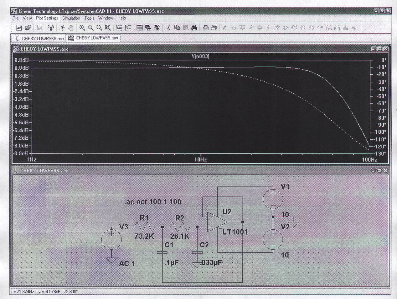

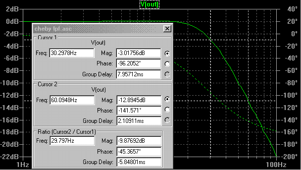

A low pass filter to pass 30 Hz and attenuate 60 Hz will have to have many poles. This 2 pole Chebychev 0.1 dB low pass illustrates the problem. The cutoff frequency is 35 Hz but 60 Hz is not down much. A 60 Hz notch might be better.

Maxim-ic has two 8-pole (called 8th-order) switched-capacitor Butterworth lowpass ICs: MAX291 and MAX7480. It can be set for -3dB at 25Hz to 30Hz by a 2.5KHz to 3KHz variable-frequency external clock (Cmos-555). 60Hz will be down 60dB (1/1000 of the voltage). Harmonics and noise will be down much more. An RC filter at its output will stop aliasing, and an RC filter at its output attenuates its small clock leakage.
I agree that a 2 pole filter at 30Hz prpbably isn't good enough, but there is something wrong with Russ' plot. It should be 3dB down at 30Hz, but is actually slightly peaked at that freq. Here is my sim of a 0.1dB, 30Hz Chebyshev. Not good, but it is down 3dB at 30Hz, and 12dB at 60Hz, pretty close to theory.

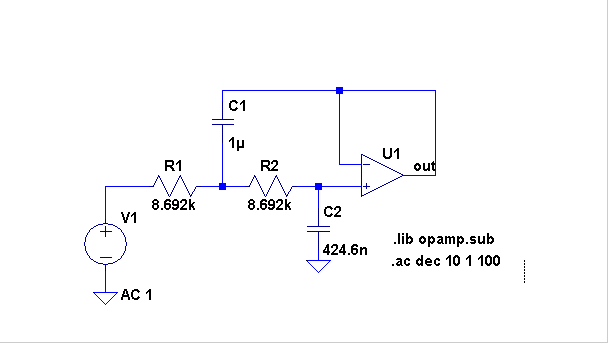

I got the component values from **broken link removed**. I selected one of their op amps at random in order to get component values, but substituted the SwitcherCAD behavioral op amp for the sim. At these frequencies, almost any op amp should work.

Kingkong's filter seems to cutoff at about 65Hz by mistake. Even your 30Hz cutoff filter is down only 13dB at 60Hz, which won't show much of a reduction.
Try plotting the response of an 8-pole switched-capacitor Butterworth LPF. On a plot it will probably look like a vertical line, truly a "brick-wall"!

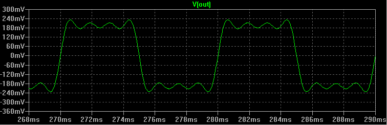

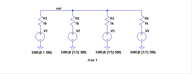

As you may know, Gibbs phenomenon is caused by the abrupt truncation of a Fourier series, and is best demonstrated by a square wave, which we know is made up of the fundamental and odd harmonics (all sinusoids by definition). The amplitude of the Nth harmonic is 1/Nth the amplitude of the fundamental. I am posting an example where the series is truncated after the 7th harmonic, just as an example. Notice the symmetrical ringing. Of course, an IIR filter will also add a lot of group delay near cutoff, causing all the ringing to be after the transitions.
Even if the signal is not a square wave, Gibbs phenomenon will be present in some form if there are significant harmonics that are abruptly attenuated (as in a brick-wall filter). Group delay is probably a much worse problem, and can be compensated for to some degree with allpass networks, but the solution is unwieldy.

Yeah, I count 7 little sine-waves. It doesn't look nearly as bad as I thought. I suppose that its edges will be rounded instead of peaky if the signal is truncated after an even-count harmonic.

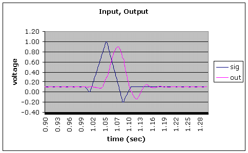

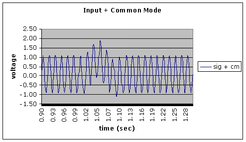

I ran a typical EKG pulse (1v pk) with 60Hz common mode (2v p-p) added to it through an 8 pole Butterworth with Fc=30Hz. It looks pretty darned good. See below. I think Audioguru is spot on.
