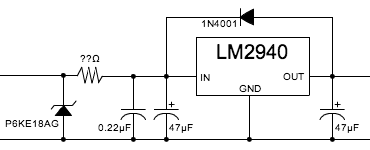

Is this the general circuit you're suggesting (see attached)?

The TVS would go on the right side of the resistor, but that is the general idea. I'm not sure 1 ohm would do you much good, so you could probably nix it. The 2940 is an automotive device, so on overvoltages during load dumps it will shut down (this is where choosing your cap values really comes into play). This is what the TVS is trying to help alleviate. The max input of the regulator is 26v, and the max clamp of the 18V TVS is 25.2V.
Heatsink would be the next question. Since you are using 3 separate regulators, that will help. Going 12V to 5V on a linear regulator is tricky, especially when you get above 1/2 amp, but 24 to 12 is a lot worse. Did you do the thermal calculations, or did you just grab a heatsink? I can help you with those as well.

If it shuts down "gracefully" (i.e. not letting the smoke out) I'm okay with that... 99% of the time I expect the LEDs to be used when the car is off anyways; I just want to make sure that IF they're used when the car is on, I don't smoke the LEDs or regulators. If an overvoltage just results in a little LED flicker I can live with it, with the idea that the filtering should make it infrequent enough to not really be noticeable.
I tried to do the thermal calculations to the best of my meager ability, but I'm also trying to keep this all in a small(ish) ventilated enclosure. Since I'm just using the regulators to "take a little off the top" (~14V -> 12V) I'm figuring the per-regulator thermal dissipation should be no more than:
[LATEX]P_D = IV = 0.6{\text{A}} \times 2{\text{V}} = 1.2{\text{W}}[/LATEX]
If I'm reading the datasheet right, and assume that the temperature in the car will very seldom exceed 140°F (especially while we're actually using the lights), I should be able to go by the following:
[LATEX]T_{R(max)} = T_{J(max)} - T_{A(max)} = 125^{\circ}{\text{C}} - 60^{\circ}{\text{C}} = 65^{\circ}{\text{C}}[/LATEX]
thus, the maximum allowable junction-ambient thermal resistance is
[LATEX]\theta_{(J-A)} = T_{R(max)} / P_D = 65^{\circ}{\text{C}} / 1.2{\text{W}} = 54.17^{\circ}{\text{C}}/{\text{W}}[/LATEX]
Since the datasheet says "If the maximum allowable value for θ(J−A) is found to be ≥ 53˚C/W for the TO-220 package [...] no heatsink is needed since the package alone will dissipate enough heat to satisfy these requirements" any heatsinking is really just superfluous. Of course I like a little margin of error, so I threw in some heatsinks :)
