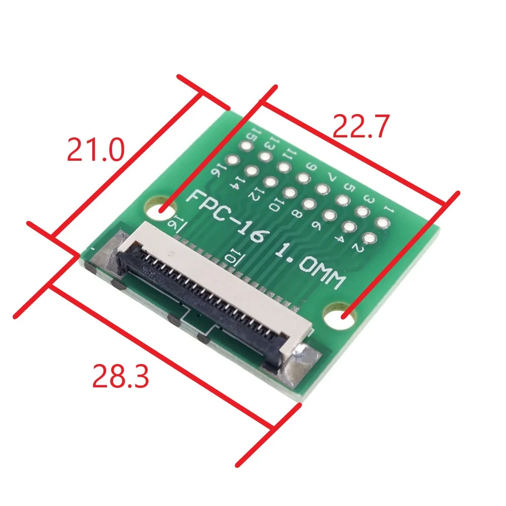

I got a 16 pin ffc/fpc connector and I want to attach it with 16 pin ic socket.
What would be the right way to do it? By soldering? Is there any adapter available?
Thank you in advance
I'd not try to use a connector like that without it being properly mounted to a PCB, it could break or the contacts separate from the body.

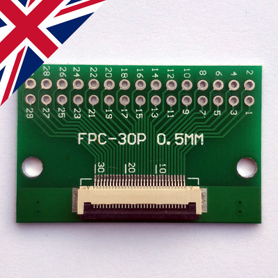

You can get ready made adapter boards from many places such as ebay, amazon, aliexpress etc.
eg.
