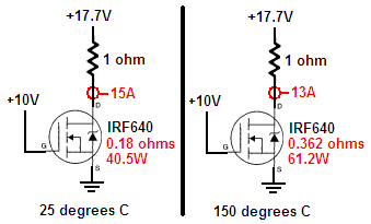

The IRL640 has a max on resistance of 0.18 ohms when its case is somehow held at 25 degrees C. If it saturates with 15A then it heats with 40.5W max.
The heat causes its resistance to rise which makes it hotter which causes its resistance to rise more which .......

This is a little misleading as well… for example take 10V source connected in series with a 1 ohm resistor and MOSFET (I know… this is just a heater). Let’s say the MOSFET has an Rds on of .01 ohms at 25°C. The power dissipated by the MOSFET would be ~1W (.98W) (I^2*R). If for any reason the MOSFET’s on resistance increases (temp affects, biasing etc.) and triples to .03 ohms, the power now dissipated in the MOSFET has increased to ~3W (2.82W). So even if the Rds on increased by 300%, it did little to reduce the current flowing through it, but the power the MOSFET has to dissipate sure goes up.

The datasheet has graphs that show the on-resistance doubles from 25 degrees to 150 degrees C. Then in my example with a 15A load, the current drops to 13A when the Mosfet is hot but its dissipation increases 51%.

I dont believe there are any.. what I mean to point out is.. when a MOSFET on resistance increases *and* causes MORE power dissipation which then further increases the on resistance.. this is thermal runaway and the part will self destruct. Audio guru was pointing this out.. yet, there is no 2nd breakdown area in the SOA...why not??? Usually the positive TCR keeps this from happening.. Audio's original comment made it sound like that is not the case.... This is what I find strange.
The power dissipation in the Mosfet is maximum when its resistance equals the load resistance. When its resistance increases above the load's resistance then its power dissipation becomes less.
