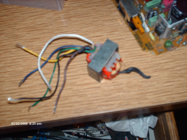

I have a ferrite core transformer and it was out of an old radio i was wondering could i use it with other parts to make a simple plug into the wall power supply? something very basic. Also if there are any other interesting ideas to use it for i would like to know.:D

Likewise, I wouldn't expect to find a ferrite cored power transformer in a radio, more likely to be an RF transformer if anything?.
That sounds most likely but that still doesn't give use enough information, it could be 455kHz or 10.7MHz for all we know. The origional poster really hasn't given us enough information to go on.
If the poster correctly identified the core material as ferrite I would agree that it's likely an RF transformer. It's also possible that the OP is using ferrite rather than a broader term - ferrous - for what might be laminated iron. A picture would be helpful.
it was hooked up directly to the power cord probably was used to convert the AC voltage to a lower usable DC voltage.
a picture or at least a more specific describtion would certainly help as already posted, e.g. dimensions and the number of taps in and out.
Is it a toroidal transformer?
here you go a picture

ahh whatever nvm this was a dumb question i was thinking it was based off the pictures on the internet really i have no clue what kinda of transformers there are and how to figure out what kind they are.
Transformer
The picture proofs that the device is an everyday's iron core mains transformer. Leave it like it is, connect the black two wires to mains and measure the output voltages. There should be two voltage outputs, one with a center tap.
To find out which wire belongs to which winding measure the resistance between wires. The winding with the center tap should have the double resistance from outer to outer tap.
You can also find out which wire belongs to one winding by looking sharp where they come from.
