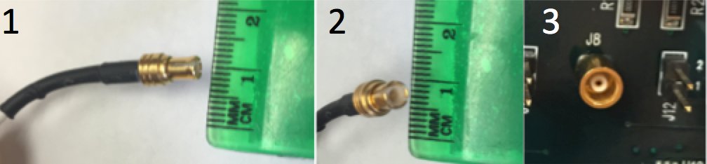

I am looking for a female-to-female jumper wire with a special connector to fix a machine.
I attached pictures of the female connector (1 and 2) and a board (3) to which the wire was connected.
Does anyone know where I can get the jumper wire (~ 15 inch long) ?
I can't find it through google.
Thank you for your help in advance.

What type of device or make and model is it from?
Hi John,
Thank you for your response. I am fixing a ~ 10 years old microplane reader (Veritas Microplate Luminometer, Turner Biosystems).

This Amphenol Listing of Connectors may help. They look close to a QMA type which is a threadless version of a SMA.
Also, someone please correct me if I am wrong but pictures #1 and #2 show what I believe are male connectors and image #3 (the pcb mount connector) is a female connector image. I realize I am getting old but figured I still had a working handle on how things work. :) The problem with getting connectors correct is there are so many that are so close dimensional wise. I am pretty sure you want male to male jumpers though and depending on the connector you may need to fabricate your own jumpers.

I contacted Pasternack through live chat. They identified that the item in the pictures is most likely "MCX Plug to MCX Plug Cable Using RG174 Coax". It took only a few hours for me to get the info from them. Ron is correct about gender of the connector. I ordered one to try.
