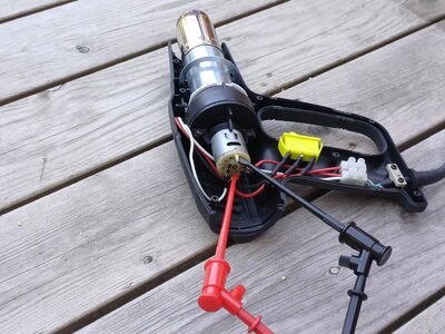

Hi. I have this simple hot air gun that have a fault where the blower motor suddenly runs slower mid operation for no obvious reason.
Disclaimer: When I describe the loss in power and try to put a number on it (i.e. half power) - this is only due to audible sound, vibrations etc. that can be felt. No measurements involved and the actual loss of power might hold a different value.
Key features of heat air gun
  • Simple DC motor + diode bridge. Most probably connected in series to some heat element within the heater.
  • Heater design: Unknown. Don't know if any connection issue within the heater may be the cause.
  • Power switch, 3 states - OFF, power.sw.pos. 1 (less heat and slower fan) and power.sw.pos. 2 (2kW heating and air blower goes full speed)
  • Fully insulated - there is no ground connection (230VAC)
This is the observed faults so far
  • While normal operation, about 5 minutes of use (power sw pos. 2 ~2kW): Speed of motor drop to about half power. The temperature seems to remain the same, but no measurement so can't be sure. Moving the power sw. to pos 1 - the motor still runs much slower than expected. After device being cooled down, starting the device in power.sw.pos. 2, it runs normal again.
  • Test run (see picture) - DC voltage being measured over the dc motor using an analog voltmeter (all test performed when power.sw.pos. 2): First run the motor DC voltage are stable at ~18V. However this was measured in semi faulty state, because after power off and on again caused the motor speed to run slightly faster (normal speed) and the DC voltage over the motor was now 20V.
    • This means that (at least in this semi faulty state) - the voltage over the motor drop compared to when it operate in non-faulty state.
  • Test run with clamp amperemeter (6A range). Motor seems to run just fine, cannot tell if it runs at full speed or slightly slower. Motor draws about 1.4A (slightly below according to the needle). However, I was not able to re-produce the fault so I cannot tell if the amperage also goes down on fault or not (it ran for over an hour at 2kW, I started the unit over again ten times during that time - but still failed to reproduce the fail state)
  • When the device goes in fault state - the speed of the blower motor remains stable. The fault state does NOT cause the DC blower motor to run erratically.

If it's two power levels, it likely has two electrically parallel elements, one in series with the motor and with the second switched in directly across the supply for 2KW.
The old Bosch one I have has what looks like two sets of elements wound one inside the other.
Could one of the elements be "drooping" after a while and shorting across to the other element? Depending on the winding configuration, that could divert some current from the motor?
It could explain why it does not do the same when on its side.
Ok, maybe I try to open the heater tomorrow. Anyway, this is how the internal wiring is done inside - but without details of the heater, it ain't very useful.
