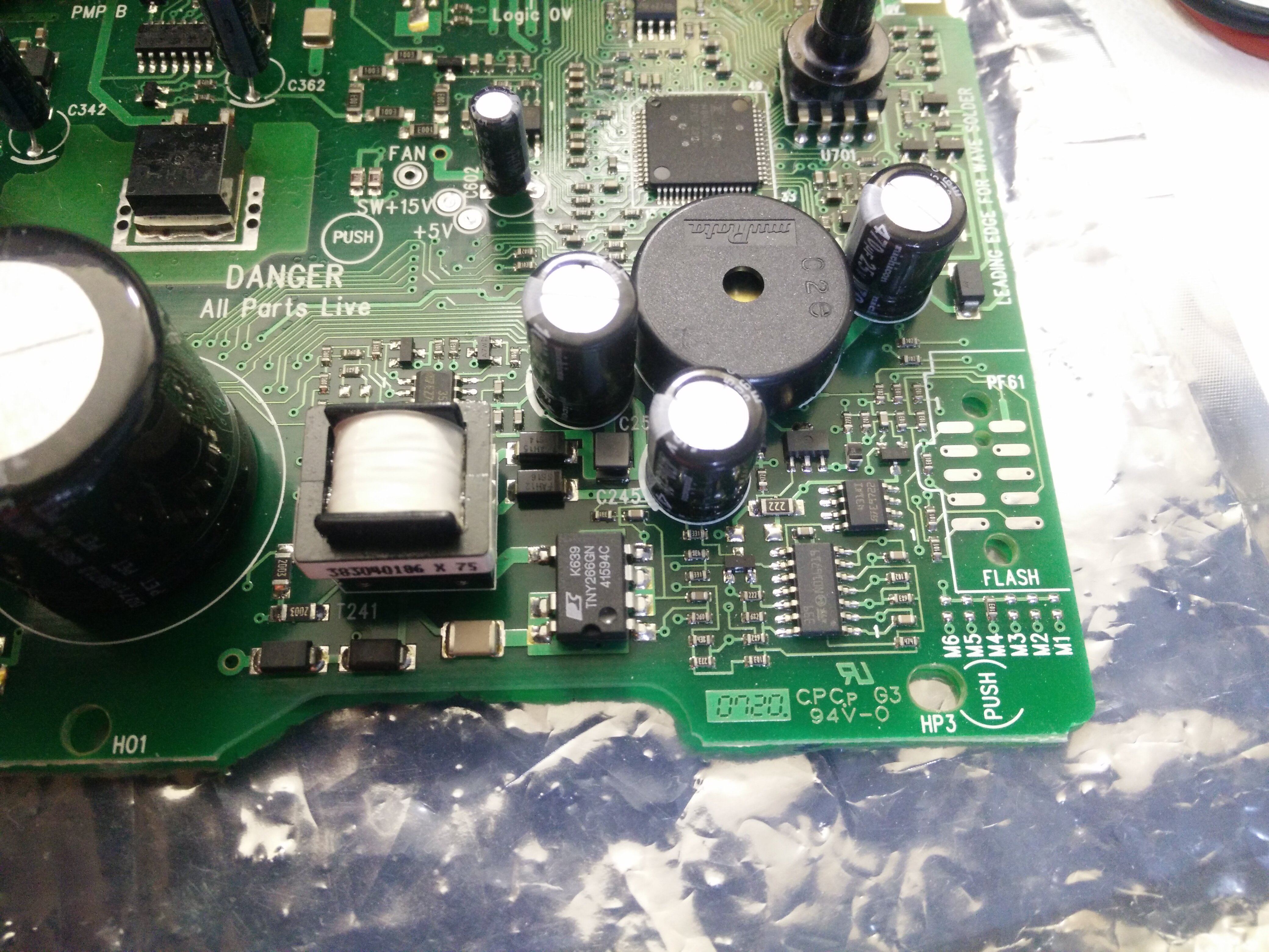

I have a WL70T60C F&P washer with error 49 displayed.
It has a 421232NAP Motor Controller with a 42085S pcb.
I have replaced a burnt-out TNY266 AC-DC Converter chip, also a 1.6A soldered-in fuse.

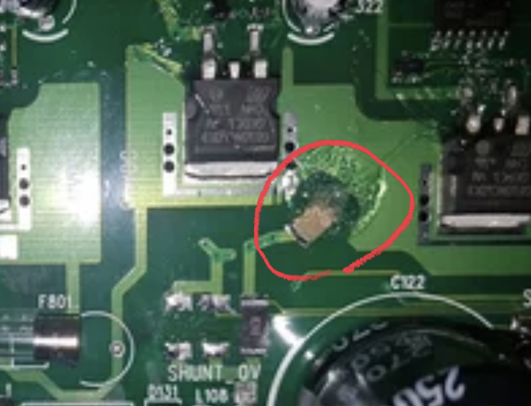

My board has two (2) SMD shunt resistors (close to the 250v 270uF electrolytics - see pic for where they were) that have burnt out.
As a consequence I cannot read their values.
Could anyone please assist with the shunt values?
Thank you

What about this mess? That looks like the copper vaporized with authority!
Hi Gophert,
No, that's ok. It's just the sealant they squirt on various components.
All is ok with that device.
My guess is if these resistors burnt the problem is much bigger, shorted mosfets, diodes and/or driver ic's.
If all else fails I have read the F&P motors are excellent for DIY wind/water turbines :)

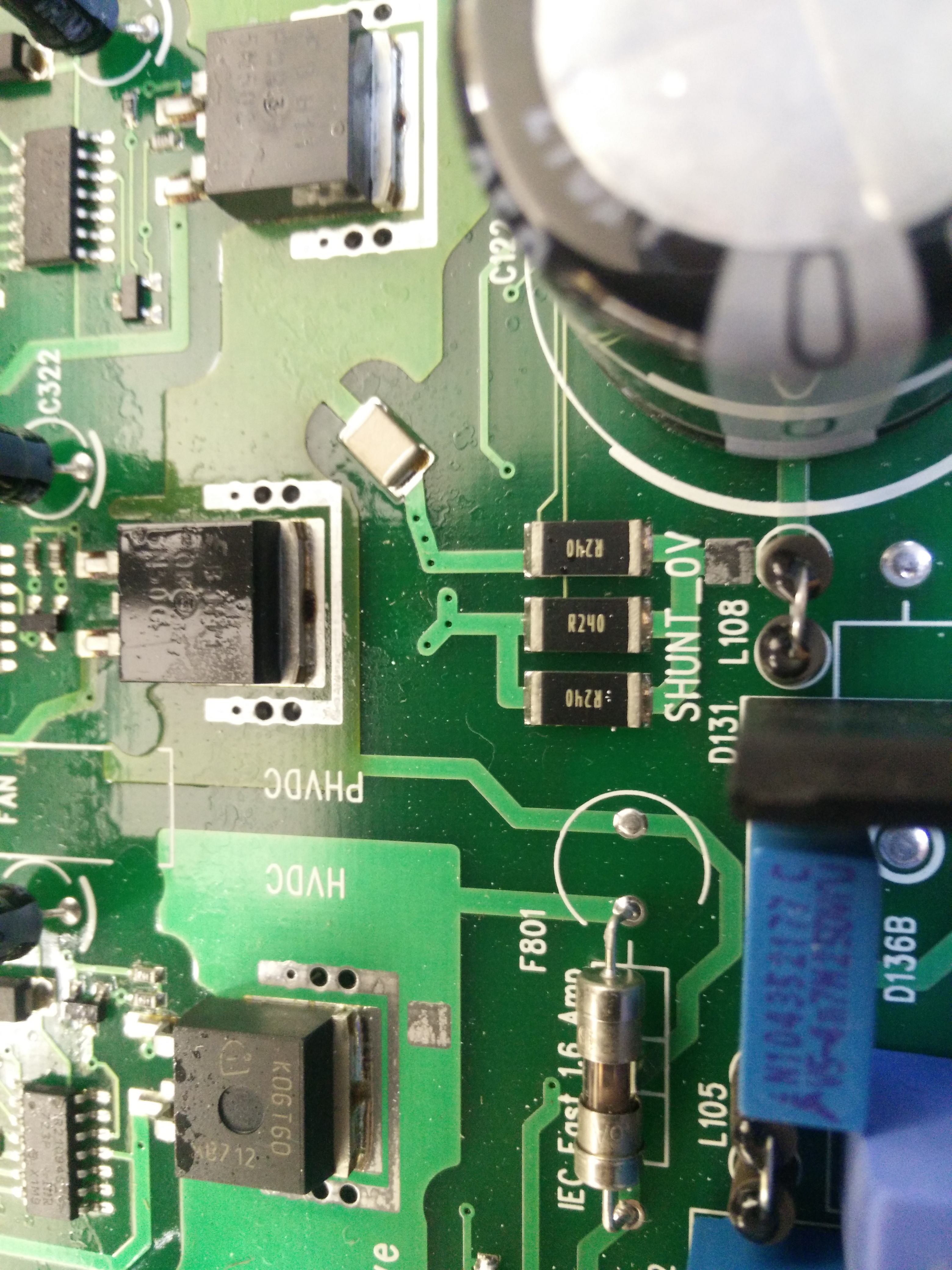

Attached is a picture showing the value of the shunt resistors you are after. By the way, my washing machine has the same error code 49 as well. I visually checked the TNY266 converter that you mentioned in your initial post and it appears to be pretty good, having no burn mark as shown in the picture. Do you remember how the part on your book looked like when you replaced it?
Looks like Gophert was right. In the later pictures it shows a component in the "evacuated" area!!
