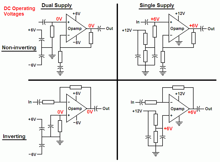

Please post your original circuit that has the plus and minus supply then show what you did to try making it work with a single positive supply.
A preamp that uses a plus and minus supply is easily modified to use only a single positive supply. Instead of its (+) input connected to ground through a resistor it is connected to half the supply voltage with a voltage divider which is fed through a resistor. Also the input, output and feedback resistor to ground need to have series coupling capacitors like this:

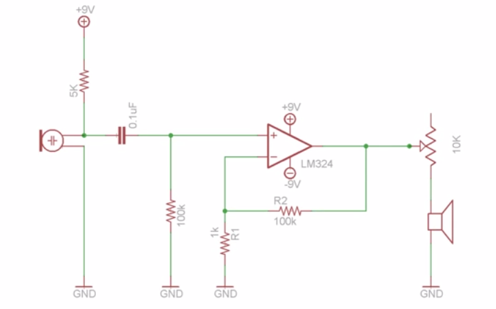

What that the partial circuit you posed earlier?, post the complete circuit exactly as you've wired it.
You posted the schematic of a very low power LM324 opamp trying to drive a speaker? An LM324 is not a power amplifier, an 8 ohm speaker needs a peak current of about 1000mA from a power amplifier when it has dual 9V supply but the minimum output current from an LM324 is only 10mA. The datasheet for the LM324 shows a minimum load of 2000 ohms. It is too noisy (hiss) for a microphone preamp, has trouble with frequencies above only 2000Hz and it has crossover distortion so it should not be used for audio.
Why did you replace the pretty good NE5532 opamp with the lousy old LM324 opamp? Why don't you have a power amplifier to drive the speaker with the preamp driving the power amplifier?
You should NEVER connect a volume control in series with a speaker. The volume control should be a signal voltage divider at the input of the power amplifier. The speaker needs to use the extremely low output impedance of the power amplifier (0.04 ohms or less) to damp its resonances so it does not sound boomy.
The datasheet for the LM324 shows a maximum input offset voltage of 9mV and a maximum input bias current of 0.5uA. Your opamp has a DC gain of 101 times so its average output could be anywhere from-6V to +6V. If the 1k resistor has a series capacitor to ground causing the DC gain to be 1 then the average output voltage will be very close to 0V.

Sorry I'm following a tutorial on you-tube and i screen captured from there. I'm working in my garage and i don't have any good schematic software to show you my circuit. I'm installing LTSpice now, I've never used it but will give it ago.

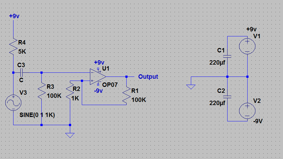

Hi Guys. I've remade the circuit I'm using with Lt-spice. This is how I've wired the circuit, you have the power rails and grand rail generated by the circuit to the right. I couldn't find the NE5532 op-amp so I just chose the op-27.
Any design improvements?

Again, your preamp amplifies its own DC offset voltage and offset current.
The datasheet for the opamp tells everything when you add a little simple arithmetic:
1) The max input offset voltage is 5mV so the gain of 101 times makes the output anywhere between +0.5V to -0.5V and the input bias current is 0.8uA max which makes the output anywhere from -8V to +8V (saturated). This DC prevents the amplifier from working and might destroy headphones. It is fixed by adding a properly calculated capacitor in series with R2 to ground.
2) The NE5532 datasheet shows a minimum load of 600 ohms. Your headphones might be 8 ohms or 32 ohms per ear so they will have a distorted low level.
3) Like most audio opamps, the NE5532 operates up to radio frequencies so it will probably oscillate at a high frequency causing severe distortion when a headphones cable connects to its output. It can be fixed by adding a 100 ohm resistor in series with its output which will further reduce the level into low impedance headphones.

The most important spec you have not told us is the impedance of your headphones and if you will connect its two earphones in parallel.
If they are the normal 32 ohms now and are in parallel then the load on the opamp is 16 ohms, much lower than the minimum of 600 ohms.
The datasheet of the NE5532 shows that the minimum peak output current is only 10mA, then the RMS current will be 7.1mA.
The power into each earphone is 7.1mA squared x 32 ohms= 1.6mW which is almost nothing. The signal level at the headphones will be only 0.23V peak which is also almost nothing. Adding a 100 ohm resistor in series to prevent oscillation will not make much difference.
The above calculation is with an NE5532 opamp having the weakest spec's for the loudest parts of music and speech. Average levels will be about 1/5th of them. An NE5532 opamp with the strongest spec's will produce output power that is 36 times higher.
If you design your mic preamp the way I showed with a single 9V battery powering it then it can drive a little power amplifier like an LM386 also powered by the battery.
When the 9V battery drops to 6V and you use two 32 ohm earphones in parallel so the load is 16 ohms then the output power will be 125mW which makes the loudest parts nice and loud and the average power will still be pretty loud.
If the battery is new at 9V then the loudest output power will damage your hearing so a resistor should be added in series with the headphones to limit their power.
