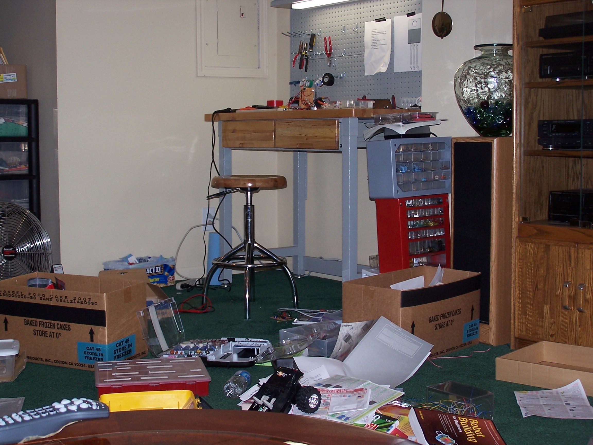

1362: The 'usual' clutter when Im designing stuff

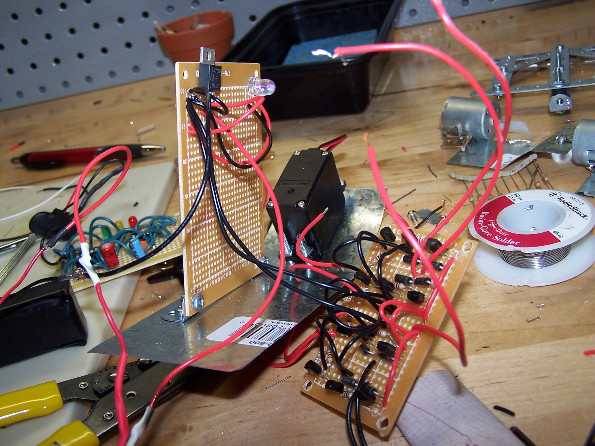

1364: Farfalle with large 8mm UV LED in upper left corner of perf board. also includes: 5v reg, dual H-Bridge, and hacked servo in front.

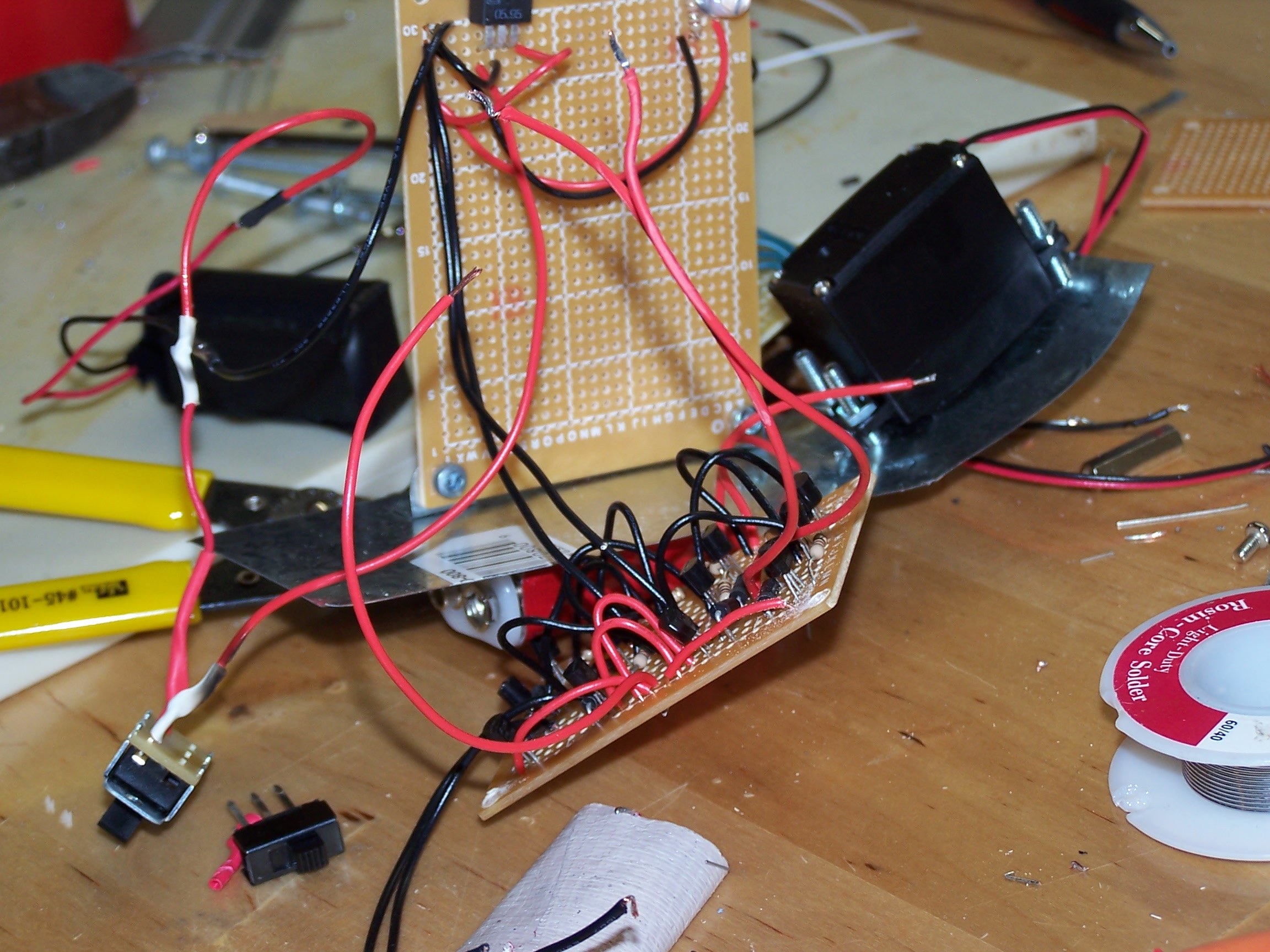

1367: another view of farfalle.

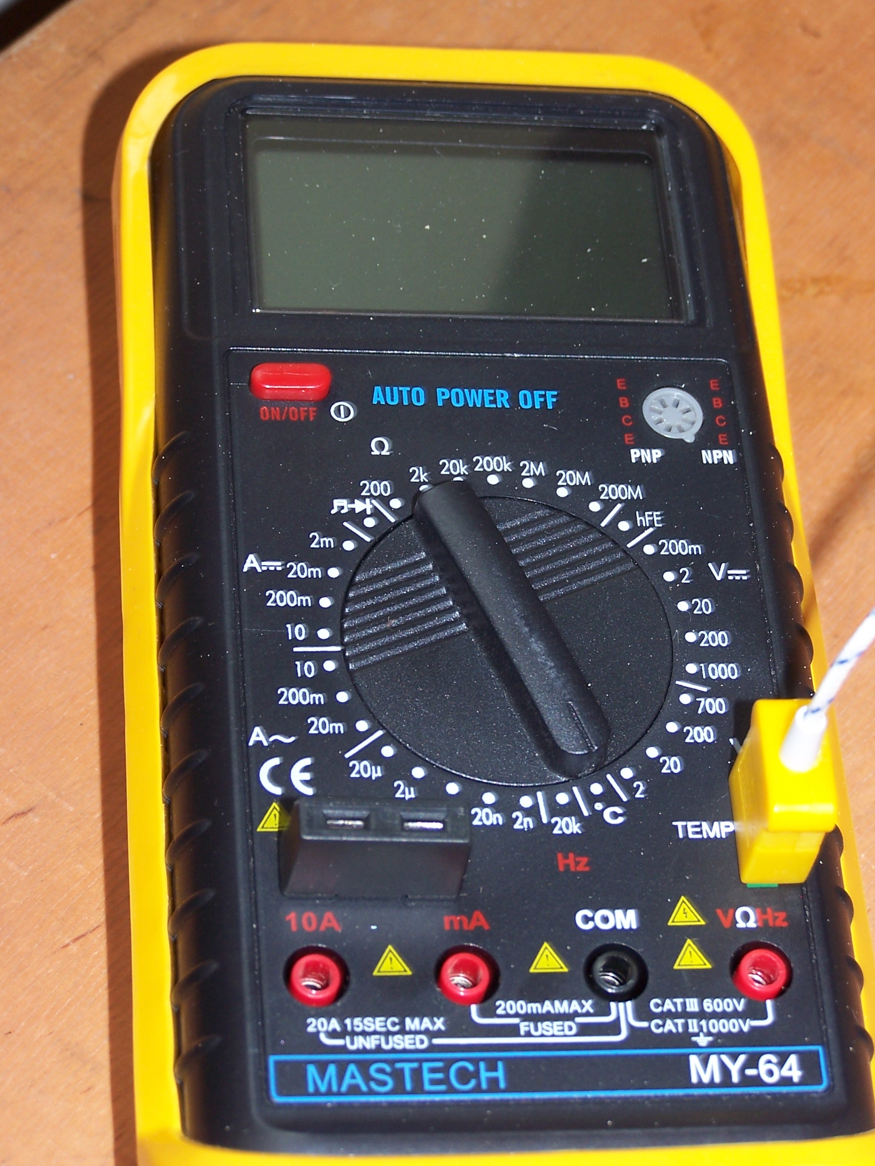

1368: My brand new shiny multimeter

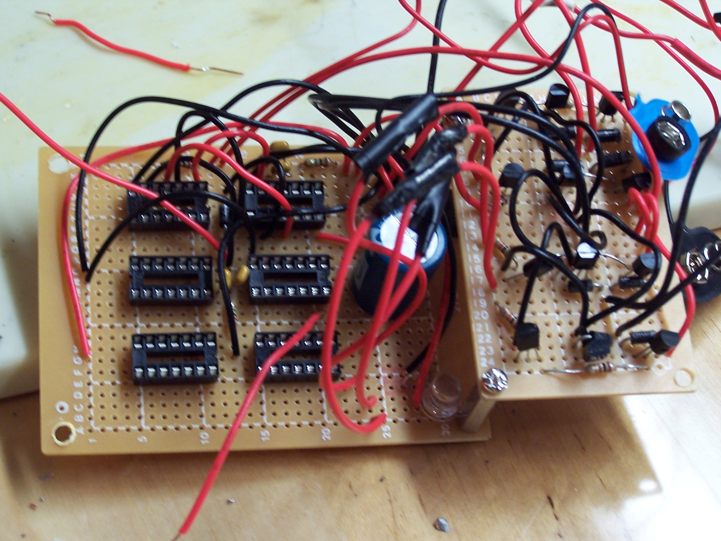

More Pictures of Farfalle!
This picture shows the 6 IC sockets for Farfalle, which to date is my biggest project. The top 3 IC sockets will hold 3 AND gates, which will buffer the signal for the 2 Shmitt Trigger NAND gates, which will control the H-bridge. The lower right socket is for the light control circuit, which will shut the robot off if its too dark, but I have yet to hook this up. Farfalle is not done yet, but will be by 7-16!
