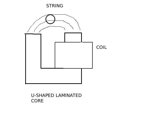

actually, something like this might work, you need one per string. the pole pieces being so close together takes care of limiting the spread of the magnetic field. it also doubles the efficiency by using a "push-pull" action. there was a device long ago called an E-Bow that worked like this.
edit: i stand corrected, they still make it..... the E-bow has a pickup coil, amplifier and driver coil in 1 simple package...
i am familiar with the e-bow, and that design is pretty interesting, but the thing is, i wanted to use the regular pickup casing because it will look like a regular guitar.
