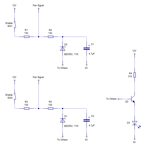

Aren't I good to you. (Attached)
Well actually, I just pulled apart my computer's fan monitor and simplified it a little. ;)
Enjoy.

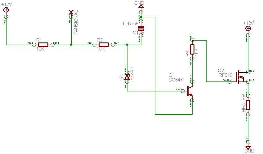

So that will turn the LED on when the fan is running, can I change Q3 for a mosfet as this will run a PTC heating element at 12v 15w, or 1.25A can I use say IRF510 as I have one at home.
As this is battery operated (solar charged) I need to save juice where possible - since I now have 2 suggestions, which would be more efficient?
No, it will turn the LED OFF when it is running.
To invert it's operation you could remove the LED alltogether, connect the emitter to 0V, increase the size of R4 to about 10K and connect the gate of your MOSFET to the collector of Q3.
When the transistor turns on, it will pull the bottom of R4 to near 0V. When the fan is working it will be about 12V.

To test the circuit, if you're using a PC fan you can just remove the fan blades / magnet from the fan. This will leave a circuit board with the coils and hall-effect switches on it. As there would be no magnet moving past the switches, it's the safest way of testing for a dead fan. (You could always poke a stick into the fan to block it, but it isn't advised !)

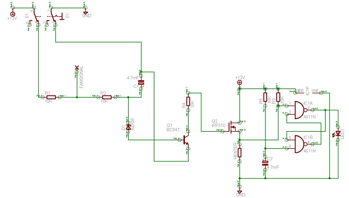

Here is the amended circuit, less the LED latch - I will add that later, just to make sure I understood what you said to invert itsoperation.
yngndrw said:
You could use an R-S latch to keep the LED on.
it also needs to be reset at startup using a capacitor
So I could replace the reset switch with a capacitor of say 1mf???
Remove the set switch and tap off the emmitor instead for a gnd?
Ok, I have guessed a bit at how it should go together - Hope it is correct but to be honest, I have not got a clue lol
Attached is what I think it should be, but here is what should happen:
Fan OK: the NAND latch supply is on, the LED will be off. S1 is switched on, the fan runs, signel will operate the circuit you provided to turn on the mosfet and heater, LED remains off.
Fan Failed: NAND Latch supply is on, LED is off. S1 is switched on, the fan is damaged so fails to run, mosfet does not turn on, heater remains off, LED turns on - Temp changes and S1 turns off, LED remains ON until NAND supply is reset.
*fingers crossed*

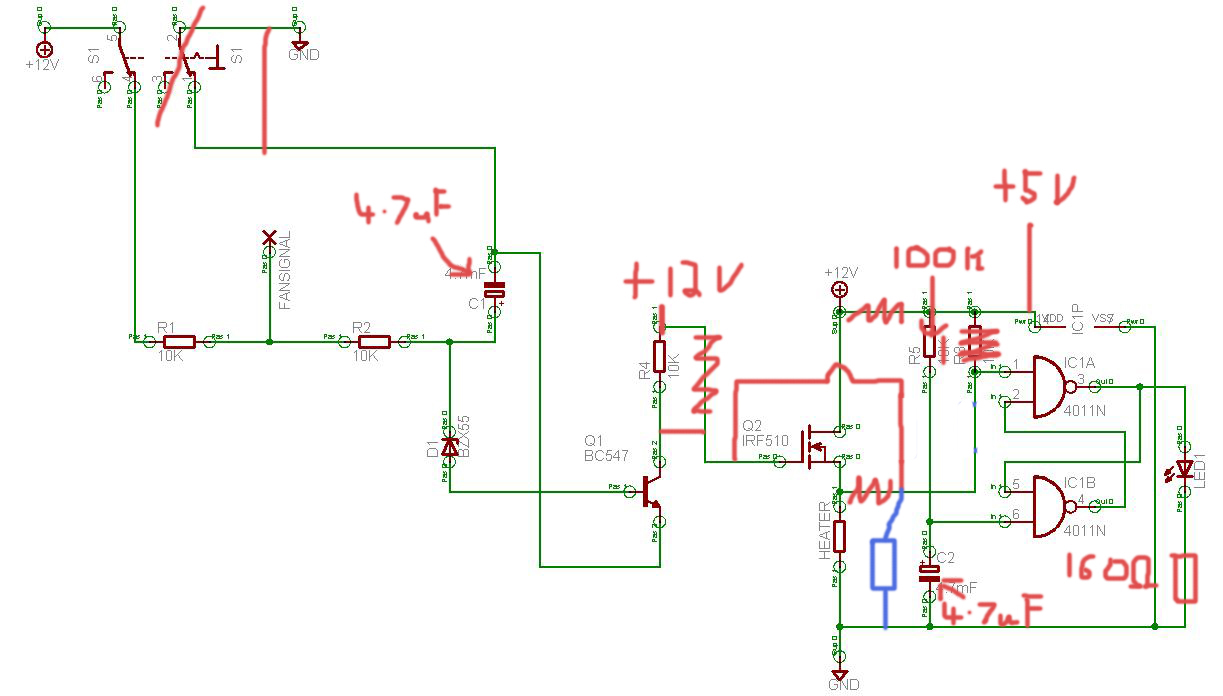

Okay you're nearly there, I've made a few changes:
R5) 10K -> 100K, will give a startup time of 0.5s. Also remember that the fan needs to spin up, so you may need more than this. Could try a 1M resistor to give you 5 seconds.
C1 & C2) 1mF (milli) is 0.001F, 1:mu: F (micro) is 0.000001F - Corrected.
S1) The GND half of S1 is not needed.
R4, top) +12V supply is needed here, Q2's gate disconnected.
R4, bottom) Q2's gate connected here.
Latch) +5V supply added as that's what they work with, also means less power wasted from the LED safety resistor.
LED) Safety resistor added, value: 160:eek:hm:
Latch trigger) Moved to further back. R3 has been removed as R4 now does it's job. Also added a resistor (Marked in blue) which should be the same value as R4. This will form a potential divider to half the voltage.
Notes: Zener diode is 7.5V.
You could POSSIBLY increase R1 and R4 to 100K to save power.
You could replace the LED and safety resistor with a single 5V LED which MIGHT save a bit of power.
Hope that helps. :)
