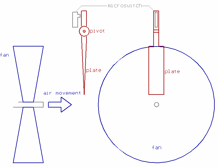

I am interested in turning on a small fan as a booster to an oven cooling system. I want to control the fan on/off with either an air flow switch or a temperature switch. The oven has a cooling fan already. It also has a flap that opens when the oven starts to cool. The oven fan blows hot air out thru one opening to cool the oven. It also draws cool room air in thru another flap. Then the flaps close.
I would like to add a fan at the inlet of this flap to cool the oven even faster. I only want my booster fan to run when the oven flap is open and the oven is cooling down. My first idea was to turn the fan on by detecting air flow out the oven flap. Or i could also use the hot oven air and a temp switch to turn the fan on and off.
Any ideas for switches for either idea? I will need to make about ten of these.
to make an air flow controlled switch there are some cheap and effective ways.
You could either use a lever moving in the air stream and attach a mercury switch to it or use a microswitch (salvaged from a worn out PC-mouse) which is touched by the lever.
See attachment.

Unless I'm missing something, why not just parallel your boost fan off the power to the existing fan. From your description they would be running at the same time.
Ken
Fan power
I don't want to run the booster fan all the time. The main fan does. The other thing i was thinking was to tap into the flap power because they open when the oven needs to cool. However, the flaps are run by a stepper motor and I'm don't think I'll be able to use that power source.
