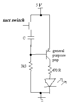

I am looking to design a fake cigarette out of an orange LED and a white bic pen. I am going to place the switch on the "filter" side of the cig so that when held, the cigarette lights.
However, if possible, I would like for the LED to slowly dim to full brightness when you press and hold the ON switch, much as how when you inhale a cigarette, the orange on the end gets brighter and brighter until reaching a maximum.
I have no idea how I would make a push-button switch gradually change the amount of power going to the LED. Perhaps instead of a switch, I should just use a very small pot? But that would make it a joint, not a cig :D

Try this and see whether it is working or not. Play with the capacitor value to get the RC time constant.
Maybe the LED will stay on all the time for the above schematic. How about this?
I don't have simulator in working place, I just use paint to draw.

Most yellow ("amber") LEDs (590nM) contain very little orange (610nM) so a filter might not accomplish much. An alternative is to use two LEDs; a red (640nM) that stays almost constant and a yellow that gets brighter when you puff.
The first circuit would stay on always and the second would flash, not fade. The attached circuit should come on gradually (1/4 second) when the switch is pressed and then fade when it's released.
