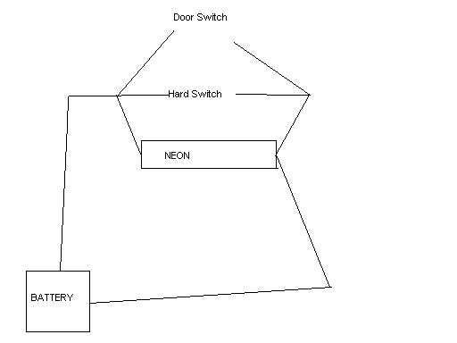

whoa whoa whoa!! :oops: Slow down mate! Series?? I really am not great would that be to make the circuit with the hard switch then add a door switch through the hard switch or around it?? :shock: :? :roll:
I dont even understand what I mean so I dont know how I expect you too???
Crude Diagram
Sorry if thats a bit crude but is that the general idea??

Your neon will have say two wires going to it. One is power the other ground. You can get what you want with just the power line. Very basic wiring is Battery power to the door switch then to the Neon. Just cut into the power line anywhere. You now have two wire ends. Attach these two wire ends to the hard switch or mount your hard switch and just add some extra wire to these ends so they reach the switch. You can get fancy and include the ground wire but its not really neccessary on a car. You can get the same result using the ground wire. I prefer to install switches on the power line. That way if something goes wrong or there is a short the power line has a switch to turn it off. This will prevent the battery from draining as long as the switch is turned off.
