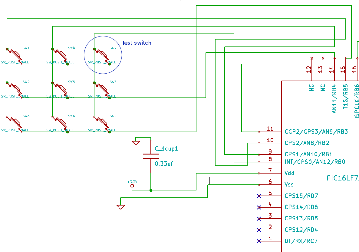

Hi All,
I am trying to get single switch of my key-pad working, but not getting any success.
The single test-switch uses pins RB3 and RB0 and an external interrupt on RB0. RB3 is output and RB0 is input.
When I push the test-switch, the INTF flag in INTCON register is getting set, but some how the ISR is not getting called. Number of times I have checked whole code and the GIE and INTE bits but not getting any clue.
Also checked that RB0 value changes when switch is pressed.
Attached is reduced code and schematic..
Kindly suggest any direction to trouble-shoot this issue..
Here are more details..
Vcc : 3.30 V
micro-controller : PIC 16LF727
clock : Internal oscillator.
compiler : CCS C version is V4.0
Thanks,
Sandy

Initially I was trying get all keys working with INTERRUPT-ON-CNAHGE, but when that did not work, I reduced the scope of debug to 1 switch and the external interrupt on RB0.
With one switch, I have checked that INTF flag is getting set properly when switch is pressed, but ISR is not getting called.
when GIE, INTE are set and INTF is also getting set, what else might be gating ISR call?
I am not getting any idea what I have missed

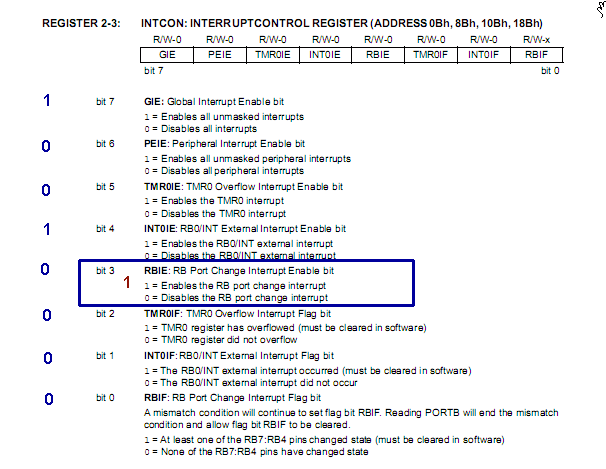

I dont use C, but it appears you have not Set this bit.
Look at this clip from the d/s.
You have
INTCON = 0b10010000
Should it be:
INTCON = 0b10011000
Sorry ericgibbs if my post was not clear and has introduced confusion, I have modified the original post #1.
I see your edit and if I understand correctly, you want RB0 to Interrupt.??
Yes, correct!
