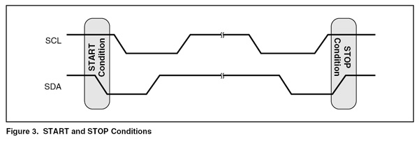

I don't use ASM, but there are simple steps how you can send START:
define E24_SDA RA5
define E24_SCL RA6
void My_I2C_START() {
DDRA=0b11111111; // make PIN SDA output
E24_SDA=1;
E24_SCL=1;
My_I2C_DELAY();
E24_SDA=0;
My_I2C_DELAY();
E24_SCL=0;
My_I2C_DELAY();
DDRA=0b11101111; // make PIN SDA intput
there are some more procedures, hope helping you ...

Looks good ... :)
Some reccomendations :
- you must have connected ressistor 2-5K between SDA and SCL lines to VCC
- when I try code, I attach two LED diodes to SDA and SCL lines and when I make my delay 1 sec, I check clearly how my code work. After I change back to milliseconds.
If you only send start and send ControlBit you must receive ACK.
This is first step what means that you code work.
And first if you have eeprom programmer write in eeprom address 0 in example 0x14 and try until you read same - 0x14.

cool ... ;)
I understand partially your code, but no fully ...
But if you execute all nessesary steps code must work.
Only one - please reminder change SDA line to Input after send ControlBit and then check for ACK (eeprom must pull SDA line to 0V). This mean that eeprom receive your StartBit and ControlBit and waiting for next command.
