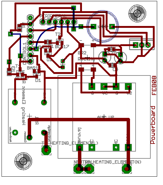

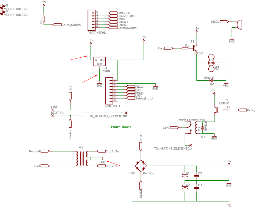

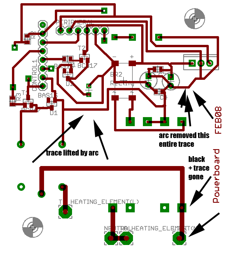

i was working on a transformer board, stepping down 230v to 12v (9v on diagram) and was checking the 12v and gnd with my scope, but when i connected the ground of the ptobe, a massive arc occured between the gnd lead of the scope and also blew up some of my gnd traces!
I dont understand because i had just checked the same thing with my multimeter and it registered 12v, no problem.
Why would connecting up my scope have caused this?
I have included the schematic and the board, showing where the traces exploded.
only the xformer, the relay and the bridge rectifier were connected at the time.
I think that my board took the brunt of the arcing, but could the transformer or the scope be damaged?

I think the circuit did not have an earth ground and its transformer was shorted from the live AC power to the secondary or to the circuit's ground (the core of the transformer).
Then your scope had an earth ground which completed a path from the power line's live to ground.
You are lucky you did not get electrocuted.
YOu are saying that his transformer secondary was floating and so when he connected a scope probe which has a connection to ground inside the scope, it made a short?
This is the same thing someone (maybe NIgel?) mentioned in another post about how an isolation transformer can be defeated by using a scope that has a internal ground connection to it's ground probe?
Are you sure that the relay connections either side of the one marked common are not the coil connections? Like this,
That or a shorted transformer are the only way it could short out.
I think that your relay is wired wrong. It looks Ok in the schematic, but on the PCB layout it appears that you've mixed up the coil connections with the NO and NC contacts!

No mystery for me! You used a GND from the bridge rectifier and a GND from the center tap of the primary windings of the transformer.
There isn't a center tap on the primary.:confused:
Your meter didn't have a problem because it is battry operated and so is isolated from the AC. But, your o-scope's supply is probably an AC/DC unit, so has a connection back to the NEUTRAL/GROUND common connection at the main box. The ground clip on your probe is hooked into this system. I've "fused" a few traces myself this way. This is why I always keep a two-pronged cheater on my o-scope's power plug. This means there is no protection by way of the grounded chassis, so can be a dangerous thing. 'Wish I'd had the extra money for the battery option. Then I'd have had isolation by default.

Always check the connection of the relay pins using a meter before use. There is no universal configuration of pin location. Your assumption of the three switch contacts all on the same end has costed you only the board this time. The oscilloscope is probably still good and you are not hurt.

The transformers primary winding is fried (infinate resistance) but the scope seems to be ok.
i just assumed that the three pins were the switch parts and the two on their own were the coil. Stupid me.
Ive got the datasheet for the relay: https://www.electro-tech-online.com/custompdfs/2008/02/f36xx.pdf
I glanced at it and obviously got the wrong end of the stick about the diagram.
Why would having the relay wrong cause this though?
thanks all.
I just looked at the underside of the relay! it says the connections on there. it never occured to me that the pins might not be logically placed.

Herbert, your PCB should have a location for an on board fuse. Always fuse circuits that connect to power, especially AC wall socket power.
I'll bet that if you disassemble the bad transformer, that you will find a blown internal current-and-heat sensitive fuse where the primary wires connect to the primary windings.

HerbertMunch said:
also, how come my house circuit breaker didn't trip?
Modern UK consumer units are fitted with a 30mA RCD supplying the ring sockets circuits.
Older types may not have it or may have a less sensitive RCD fitted.
You may need to just check your consumer unit has a working RCD (there is a test button on it) and if necessary, use a separate plug-in type rcd for your electronics workbench for now if you don't have adequate rcd protection.

It sounds to us you are still unsure why your traces blew up. We have given you the correct cause and you need to make sure you understand why this connection error had resulted in the blown traces.
Hint: Think of relay contact as closed between (Common and N.C.) and will conduct current from the common center pin to any circuit having a connection to the N.C. contact pin. If you put LIVE on the center pin, then the N.C. pin will be at live potential too. Did you connect anything to the N.C. pin?
The scope lead clip is earthed, did you touch this earthed clip to any point on circuit which has LIVE potential?
