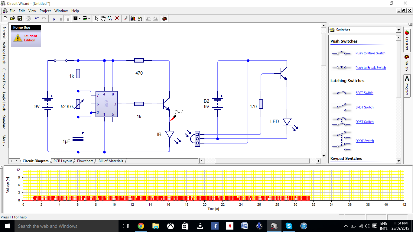

I need help understanding how Infra-red works (Couldn't find any good explanations on the internet).. Lets say you want to press a button sending a IR signal out to the device that is gonna receive and lets say the device just turns on a LED or light (Something simple so I just get the concept). What components will be used in this basic circuit? Does the infared signal just complete the circuit on the so called device like a transistor (E.g on a transistor when the base pin is more then .7V (I pretty sure) it will allow the current to flow through the other two pins)????
Thanks (I haven't learned anything at all about IR so please keep it simple and don't judge haha )

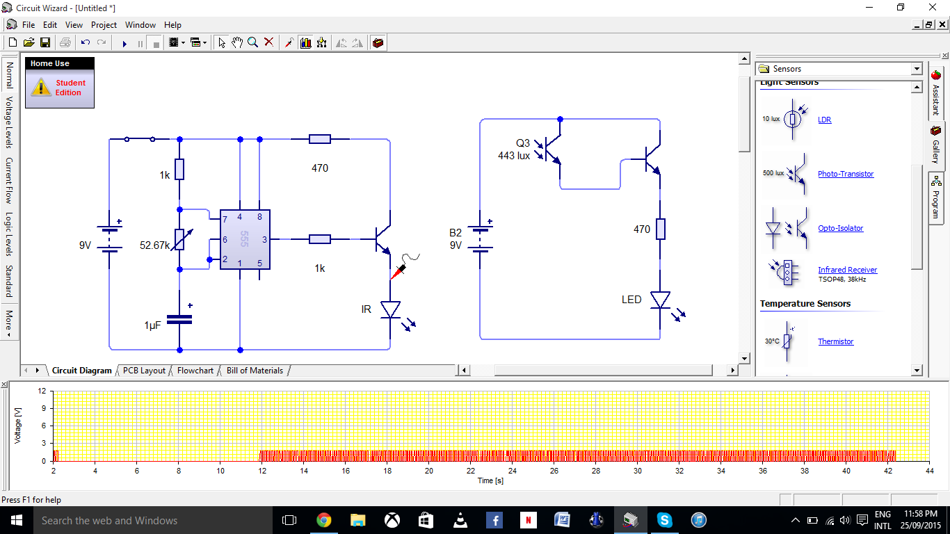

The simplest approach would be to use an IR LED to generate the IR signal and a photo-transistor to receive the signal.
If the received signal is of sufficiently high intensity, then the photo-transistor will turn on.
The photo-transistor can then drive another transistor (since the photo-transistor's output current is generally small) to amplify the signal sufficiently to light an LED or whatever else you may want to switch.
Of course this ignores the effects of any sources of interference, as mentioned on the other posts, from other external light sources.

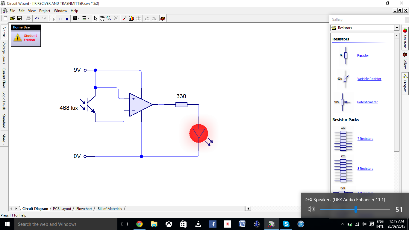

Is this concept basically correct?

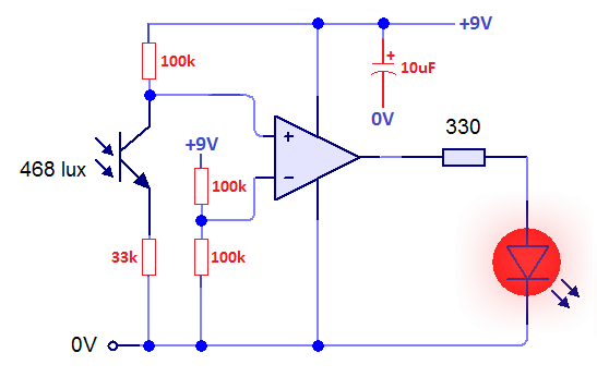

Many opamps do not work if an input is at the power supply voltage like in your circuit. Also, when there is no light then the voltage at the (-) input is not defined so the transistor and LED might never turn off.
I biased the (-) input of the opamp at half the supply voltage and added a collector resistor and an emitter resistor so that the (+) input never gets near the supply voltage or near 0V.
I added a power supply bypass capacitor so that the opamp does not oscillate.
