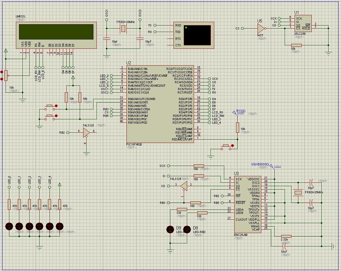

I have built the circuit on Proteus ISIS using PIC18F4620 and ENC28J60.
I took help from schematic provided at http://www.ljcv.net/library/sc/pic10t-2.0.pdf
However when i use the TCP/IP stack provided at Microchip TCP/IP Stack v3.75 Modified Version for PIC10T, i dont get any anything on LCD nor does the ethernet module (ENC28J60) picks up any IP from DHCP. I have tried without DHCP and it still doesnt show anything on the Virtual terminal.
I have also tried changing the configuration by using Button 0 but still nothing.
Can anyone guide me what i can be doing wrong or why is the LCD displaying nothing and also why is the ENC not working.
I have attached the image of schematic i made.

It took me a week or maybe a little more but i have done what i wanted. YEEEEE!! :D
I can now control my hardware (turn off lights (LEDS) and read/write data on to my microcontroller board through ethernet and also internet.
My webpage for this control and monitoring feature is AJAX based with JSON so data can be directly evaled with javascript sent from C.
Thank you all for your support and suggestions. Couldn't have started without you guys.
I must say, microchip's TCP/IP stack version 5.20 is really easy to use.
I have used Explorer 16 board to interface ethernet with my controllers data bus using RS-485.
