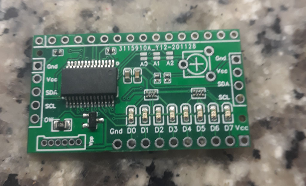

Just did password recovery and the 20 board I got assembled (including a 16F18854) cost AU$98 including postage ($20).
The boards,
The two items above the LEDs (D0 to D7) are resistor arrays - four times 0402 resistors in a single package. No way could I have soldered these boards myself.
The 3 pin chip is a DS2411 one wire device so each board has an individual serial number.
