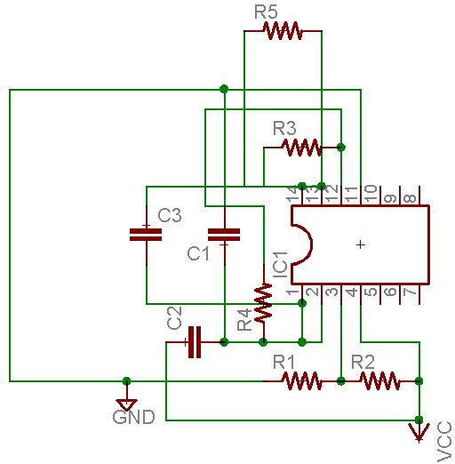

recently i tried to convert one of them into PCB... it's a improvement some guy did...based on a design which belongs to Nuova Elettronica.
(This is the improvement and not the original which exists on an other forum. The original can also be found online)
and this is my unfinished try on Eagle to convert the above into schematic and then PCB. :( :(
it's my first time on Eagle it's total mess right? can someone give me instructions what to do?

as i said to a previous post... my try is unfinished...
i didn't knew if i'm doing it correctly and i got disappointed from the outcome! so i need some advices what to do and how to continue so a can make the PCB layout.
Build it as specified, then try to simplify it. Your version does not even appear close. Why would you not build it like its original design? It's only one IC afterall.
