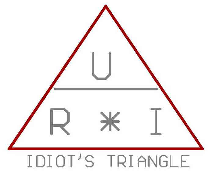

Hi All,
I read many posts concerned with resistance, current & voltage calculation.
The key to this is OHM's law.
for everybody having problems using the law properly here is an idiot's triangle to solve for any value without errors.
Instructions: Cover the desired value, e.g. Voltage in Volt (U) to calculate for it. What is left of the triangle is R * I. Calculating for either R (Resistance in Ω) or I (Current in Ampéres) (I standing for intensity) cover either one of both. The remainder of the formula is clearly visible: U/I respectively U/R.
Good luck! :)

The (U) looks like a U rather than a (V) "Vee",to me. In the USA we have used E for voltage for many years, but I understand the V.

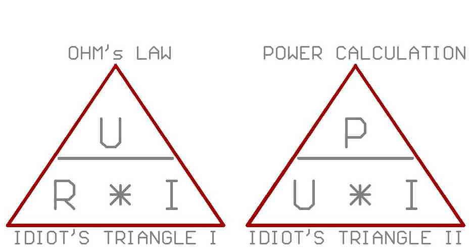

hi Hans,
That magic triangle has more whiskers than Santa Claus..:rolleyes:
I agree its useful in helping Tyro's to recall Ohms Law.
The triangle can also be labelled with P at the top in place of the U/V
and the other two symbols with U/V, I
P
V* I
Regards.

Good idea, Eric.
I'll make one triangle.
Here's some more.
I found the formula wheel somewhere in the internet.
