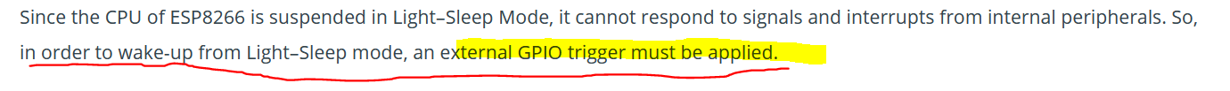

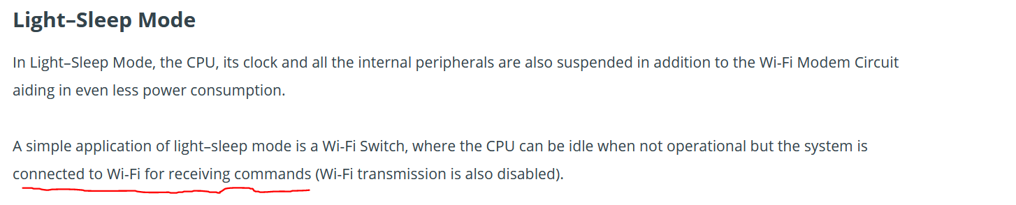

I read that but do not understand this:
So with Light sleep it can receive but cant transmitt. And in Deep mode it can be interrupted only with some timer/gpio pins?
Not even in light sleep can cpu wake up after data is received over wifi?

I am just curious how can be esp8266 waken up remotely from light sleep mode via wifi using mains powered esp8266?
It looks it can be waken up only with timer interupts or gpio pin.
So how can i ask "slave" in sleep mode for data from "master".
