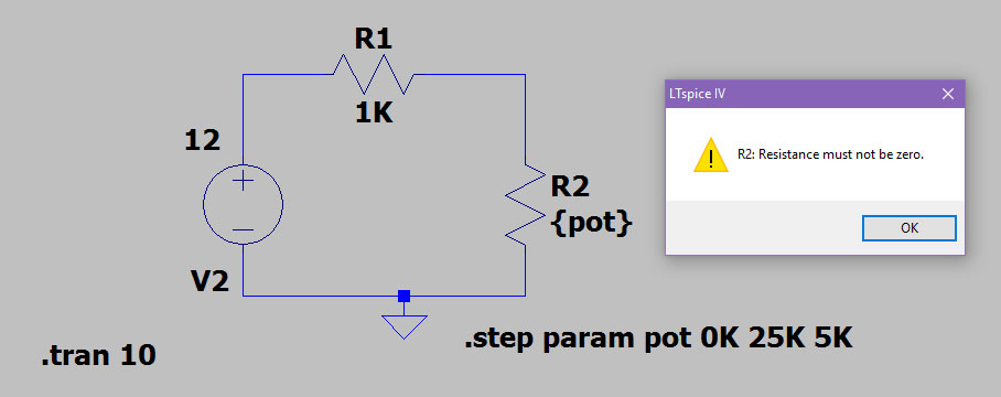

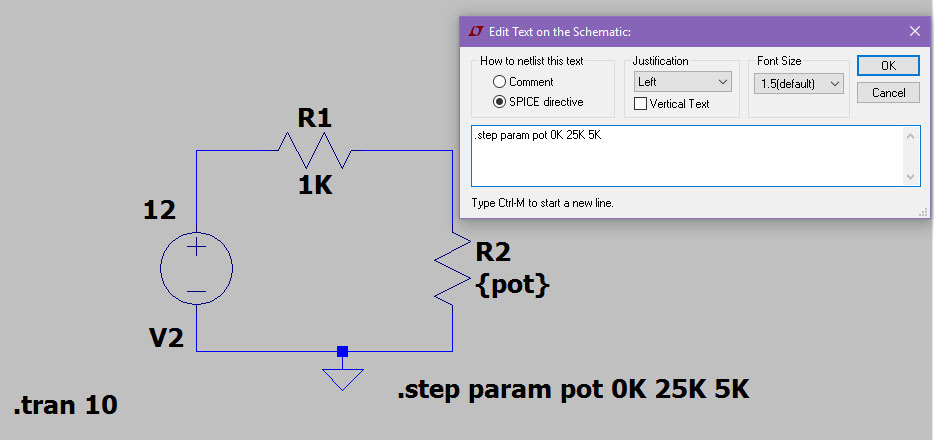

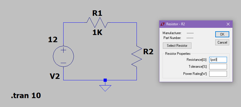

Hi all,
I've decided to use LTSpiceIV for my small projects. I like it very much. But I have a problem to step a resistor value. I do everything as is described in tutorial, but it don't work. I'm adding some screenshots. Just to say - I've downloaded a program three days ago from official site. No problems and error messages during installation. Yesterday I've downloaded two files from LTWiki - LargeCollection.zip and LtSpiceIV_Plus_12_2009.exe and installed them. Is my problem related with these files?
P.S. I've fully uninstalled the program. Then I've installed it again. The error still remains...:banghead:
Thank you in advance!

All variants of Spice derived from Berkely Spice, including LTSpice, have always had the restriction that the value of any Resistor in the netlist cannot be zero Ω. Think about what happens when LTSpice tries to evaluate this: I=E/R.
When stepping a resistor value, just start with a minimum value of 1uΩ or 1mΩ. Change your command to
.step param pot 1m 25K 5K
and it will work as you intended. During the first step, the value of the resistor will be 1mΩ, which is so close to zero that you will still see how the circuit works with the pot diddled to it's min. value...
The error message told you exactly what was wrong... There was nothing wrong with the installation.

The problem is the 0 value in the pot Step, it will not allow a zero value, try .step param pot 0.01 25k 5k
Post your asc file.

Your LT_3.jpg attachment plainly shows the Error that we are talking about: [R2: Resistance must not be zero].
Did you not understand that? :confused:
