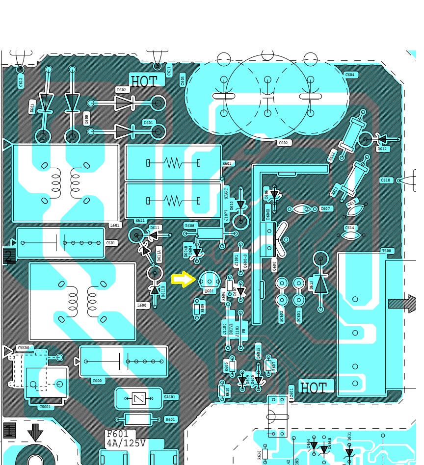

Attached is the schematic. The location is marked with a yellow arrow.
Location is Q601 for the 2SC2120-Y Transistor.

Thanks for the picture of the transistor location in the TV, but afraid that is no help. I should have made it clear that it is the schematic (circuit diagram) rather than the physical layout that would help us know what the transistor function in the TV is. :happy:
Don't worry though. As I said previously, going by the data sheet for the 2SC2120, it is not going to be in a particularly demanding role.
