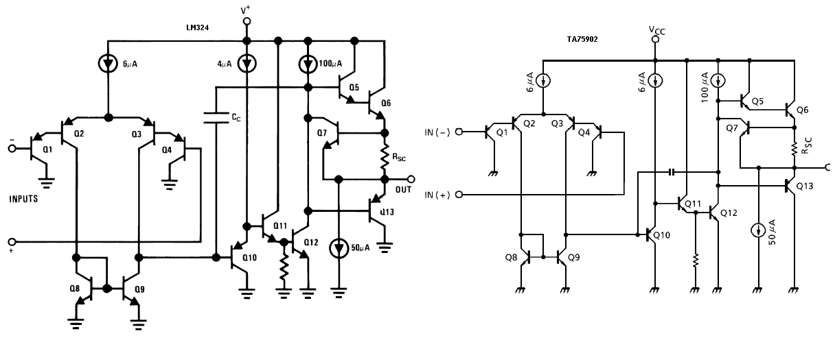

equivalent ic for TA 75902 p (quad op-amp)
Pin-compatible with LM324 and the internal cct almost same.
