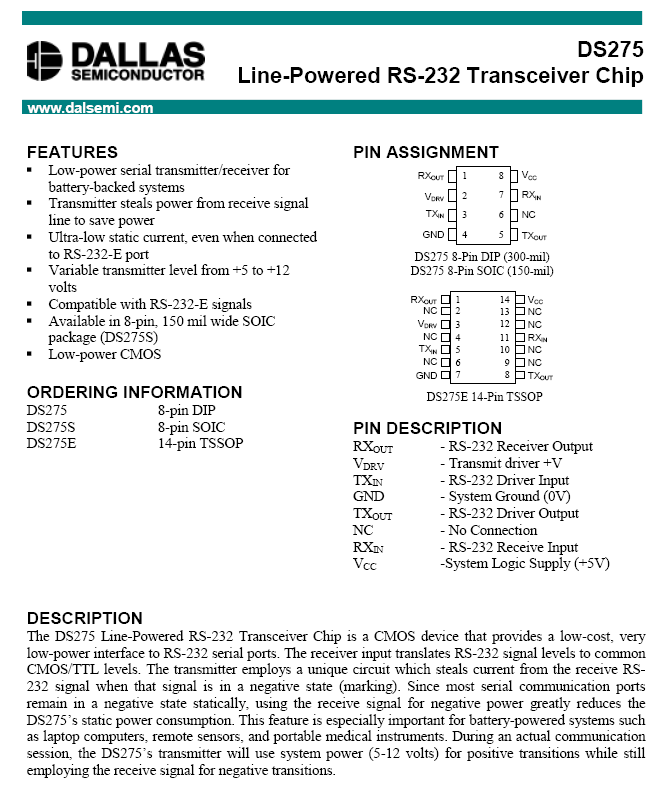

can somebody help me with the equivalent of DS275 Ic.
schematic , pin diagram attached
im planning to build a programmer for 89c51/52
DS275 is not available and im running short of time as my last date for submission of project is too near. help would be greatly appreciated
A pin compatible part probably isn't available - Dallas semi got acquired by www.maxim-ic.com, and unless you want to try getting a sample directly from them, it's probably easier to work around it.
Use a more standard MAX232 chip (google and you'll find a lot of schematics)
Or look in the https://www.electro-tech-online.com/forums/electronic-projects/ section of the forum for Mike's "Simple RS232-to-TTL Adapter". It's two transistors and a couple resistors and would probably be a functional replacement for the chip.
