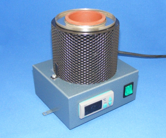

I believe the commonest production line method for stripping the ends is a solder pot: That's a small heated tub of solder, sometimes with a special molten flux floating on the solder to protect it.
Otherwise, the wire can be dipped in a suitable flux before it's put in the solder.
It should be used near a fume extractor.
